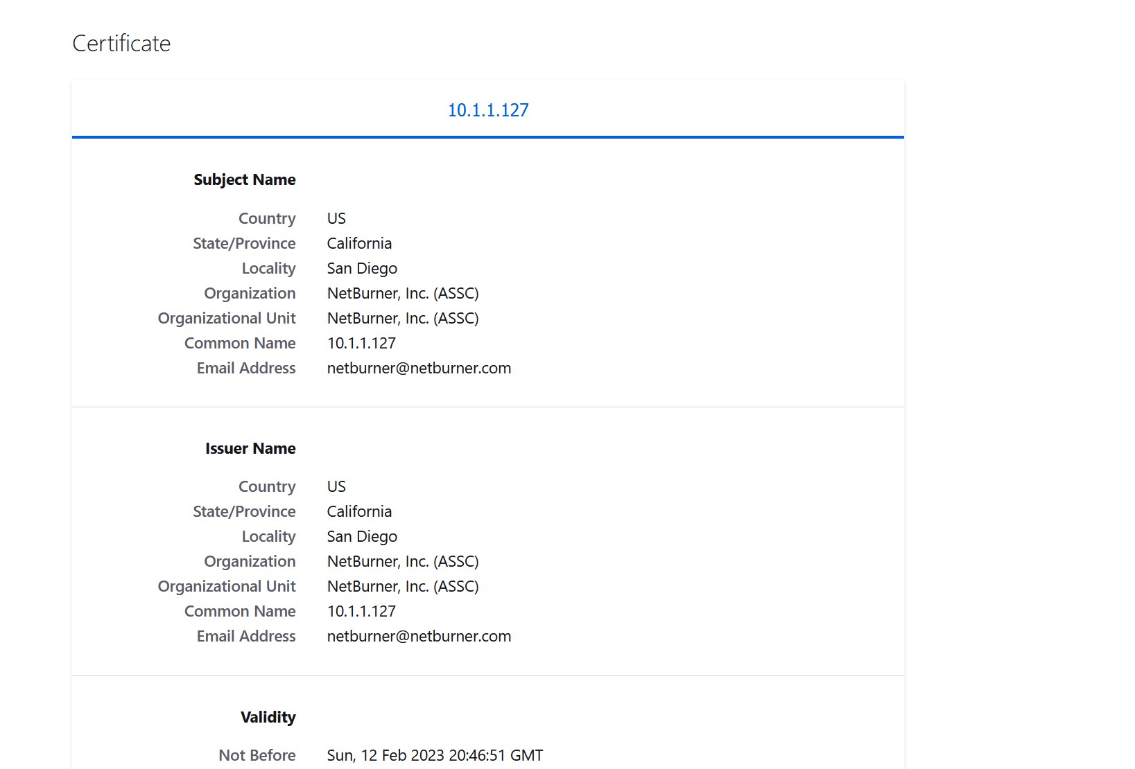

I attached my .bin file of the simple example for the MOD5441X. See if works for you.

Seems to work fine for me. See attached.

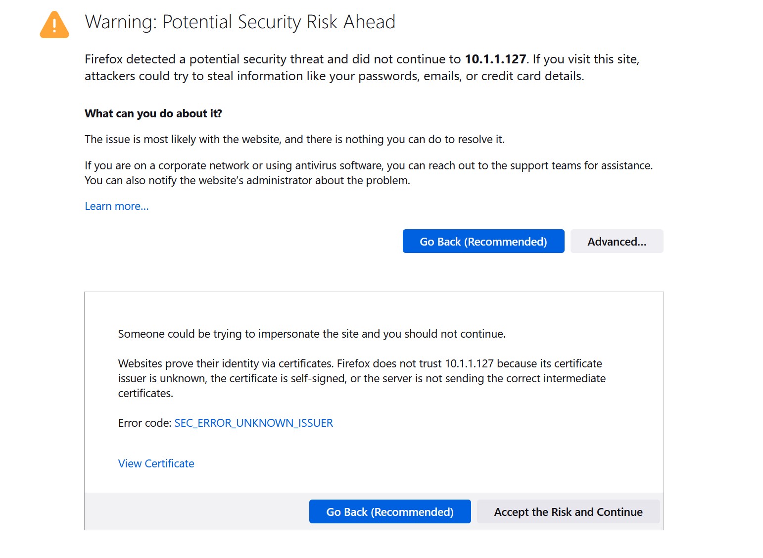

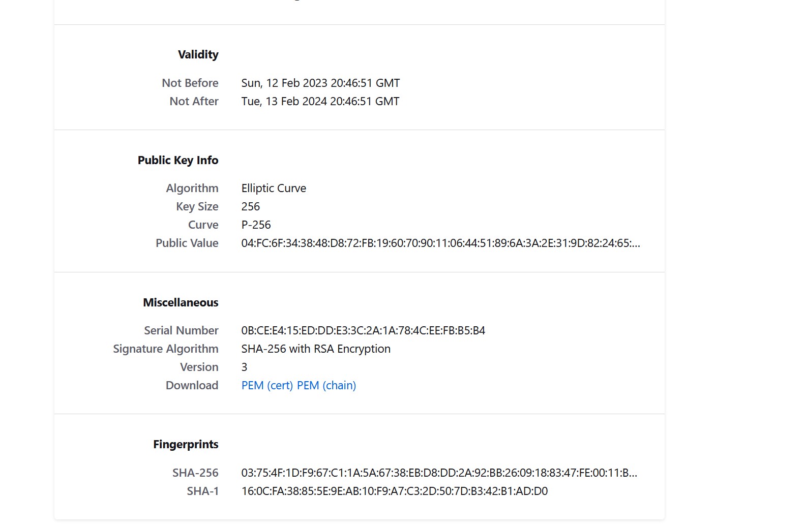

I see that you're using Firefox, so I installed Firefox and tried it and it works with Firefox. It does not work with Chrome or Edge. My coworker thinks the issue is with the Alternate Name. Apparently, Firefox doesn't need a valid Alternate Name, whereas Chrome and Edge do.
