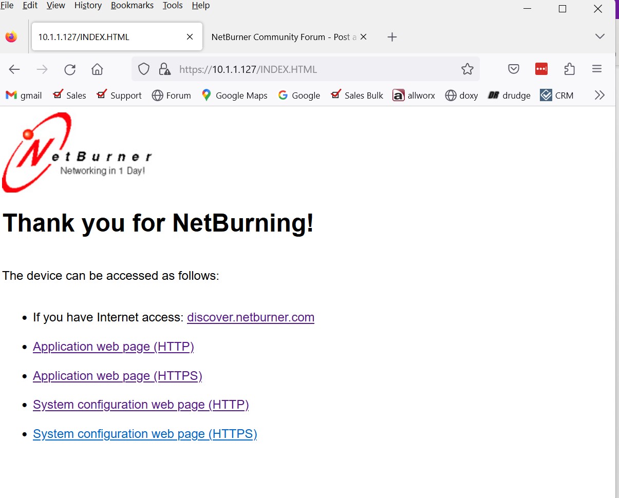

I have just built and tested that example on a MOD54415. I do not see that error. As expected, I do see a browser warning since the certificate authority is not installed on the browser, but the cert is valid. I would attache the image, but it would be invalid for your since your IP address of the device is different (common name).

ormatted time string: 2:09:02 PM
Application: On-board Cert Generation - Simple
NNDK Revision: 3.3.9
IP Address: 10.1.1.127
The device can be accessed as follows:
- If you have Internet access: discover.netburner.com
- http://10.1.1.127 for application web page (HTTP)
- https://10.1.1.127 for application web page (HTTPS)
- http://10.1.1.127:20034 for system configuration web page (HTTP)
- https://10.1.1.127:20034 for system configuration web page (HTTPS)
