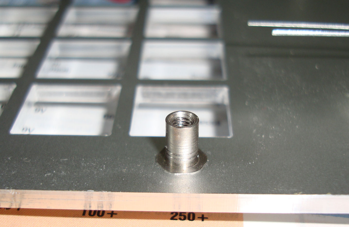

I have also attached an image of the rear mounted inserts that Germany offers. These are great for making front panels with PCB's on the rear so that you avoid having to drill holes all the way through and have screws showing on the front. They come in different lengths. Much neater for the final look.
