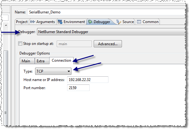

Re: eTPU, UART and Debugger
Sounds like something in the debugging setup is still stuck on the serial port. The fact that debugging works over TCP argues against that, but it's worth a quick trip to the configuration debug area just to make sure. Maybe try changing some settings and then changing them back?
