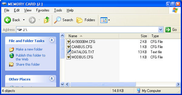

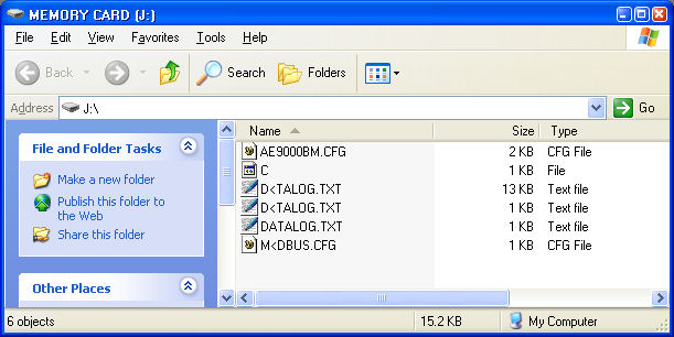

I am still getting corruption somewhere in the code. See attached images of the directory on the disk before and after initalising and then trying to open the files for reading. All open calls fail and then when I remove the card and check in the PC, I see the corrupted names and strange directory entries.
I have confirmed that the OSCritEnter and leave are implemented correctly.
The touch screen drive never gets called unless the user touches the LCD anyway. It only gets called once on starup before any file system calls to setup the driver.
- Flash Bad.jpg (60.4 KiB) Viewed 6074 times
- Flash Good.jpg (58 KiB) Viewed 6077 times
