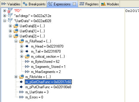

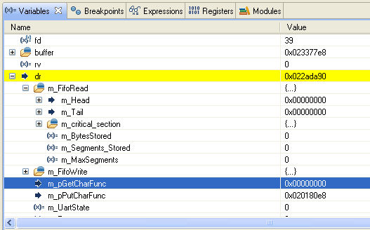

What I have noticed is that there appears to be no received data although I can see this on the SCOPE when looking at the RXD line into the MOD5234. All the init seems to work. I don't have any TX or RX software flow control but hardware is enabled and both RTS and CTS remain low (active state)
The DO loop below in PPP.CPP line 672, never gets reached.
do
OSSemPend( &read_semaphore, TICKS_PER_SECOND );
if ( !dr->m_FifoRead.Empty() )
do
if ( ( rv = dr->m_FifoRead.ReadData( buffer, 80 ) ) > 0 )
ahdlc_receive( ( char* )buffer, rv );
while ( rv > 0 );
}//If not empty....
Has anyone managed to get PPP to work over GPRS? I saw the code in the Apps forum and that is what I have here. I am using a Telkomsel SIM on the Indonesian Telkomsel network. My Rabbit based design works fine with this same SIM so I know that it is not a network or SIM issue.

Doing a little more digging into why I am not receiving any data and I am finding that if I break point into the processppp function and then check the variables for the UartData, they don't match up.
See attached images of the 2 screen grabs of the variables. This code below gets the UartData for the serial port in use, in my case, 2.
UartDataRec* dr = UartData + ( fd - SERIAL_SOCKET_OFFSET );
Looking at the m_pGetCharFunction highlighted and the m_Head and m_Tail for the fifi read! m_pPutCharFunc is correct.
I don't think this is corruption as dr is just a pointer and the Expressions view is OK.
I am wondering if there is a bug in the code for use with UART2??? Still working my way through it all to find it.
If I open the serial port I can send and receive data to the modem. The PPP init also works but only fails when in the processppp section.!
- ppp_2.jpg (43.98 KiB) Viewed 5181 times
