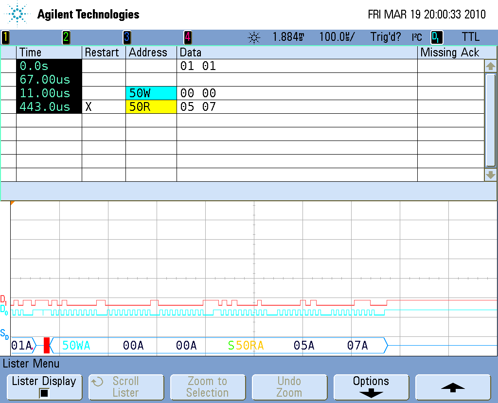

I've been able to successfully write and read back to the EEPROM (according to my logic analyzer), but the data I get back on a read is incorrect - for the first byte of the EEPROM I'm getting the address/control byte, and fo rthe second byte read I get the first data byte.

The logic analyzer shows a write of EEPROM address 0, followed by a read of the two values I had previously written to EEPROM (0x05 and 0x07). However, in my code, the values stored in my eeprom_cfg structure are 0xA1 for eeprom_cfg.unit_id and 0x05 for eeprom_cfg.volume.
Does anyone see anything wrong with this read sequence? Again, according to my protocol analyzer, the proper data is being returned.

The attached image shows the EEPROM sequential read sequence. Shows the setting of the EEPROM start address to 0, followed by a sequential read of two data bytes.

The first byte is actually not garbage - it is the Address byte (50H<<1 + read bit). That was the last thing put in the i2c data register by the driver before the first read. So it's as if this value is being returned on the first read.
