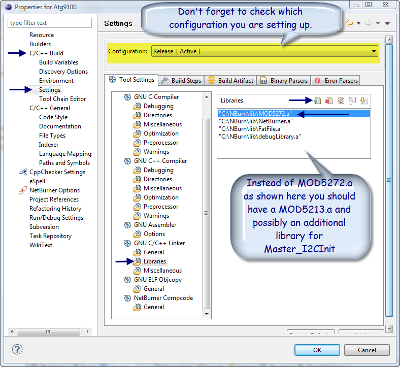

I have used the I2C code on the MOD5234 for a while now with no problem. My latest project uses the MOD5213, but I cannot get the I2C to compile. The example was written for DevC I guess, when I create a new 5213 project and import the example main.cpp I get a slew of errors.
Of course I don't need the example, that is just a stepping stone that I stepped back to to try to figure out why NBEclispe cannot find the 5213 version of Master_I2CInit(). I've got the #include <i2cmaster.h> but I get
undefined reference to `Master_I2CInit'
I've checked that the Target Platform is indeed set for MOD5213, which I set when I created the project.
I think I'm missing something simple, but a working NBEclipse example would help.
Sam
Re: MOD5213 I2C2Serial example for NBEclipse?
This is general advice, I don't have a MOD5213 or use I2C2. However, it sounds like the error you described is a linker error not a compiler error. In other words, it saw your i2cmaster.h file and expected to find the routines promised by that header but did not. You may just need to add a reference to the missing library (see the attached image). I would think you would only need MOD5213.a but it's possible that I2C support is in a different library. You could check your working MOD5234 project and figure it out from there maybe.

Thanks Tod,
I hadn't checked that but I do have the MOD5213.a in the libraries list.
Must be something else...
