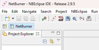

I reinstall 2.9.7. attached is the predef header file without any modification it's in rev 2.9.7. the NB_SSL_SUPPORTED is commented out by default.
the ide itself seems in 2.9.5

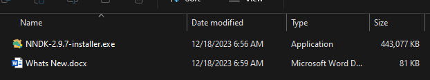

not sure if it matter, the installer was downloaded back in 12/18/2023
