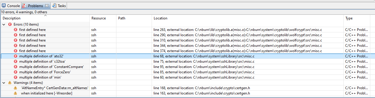

I did a fresh installation of NNDK 2.9.7 with MOD54415 and SSL serial number. I created the example located at: C:\nburn\examples\SSH\sshServerUserAuth. I then uncommented the `NB_SSH_SUPPORTED` and `NB_SSL_SUPPORTED` in `predef.h`, and rebuilt all system files.
When I attempt to build the example project, I encounter multiple definition errors during compilation.

I think there is something wrong with your install, you should not have to uncomment the SSL in 2.9.7, as its always enabled. Can you rename your \nburn directory and do a clean install of 2.9.7?

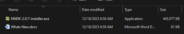

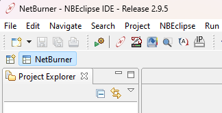

I reinstall 2.9.7. attached is the predef header file without any modification it's in rev 2.9.7. the NB_SSL_SUPPORTED is commented out by default.
the ide itself seems in 2.9.5
not sure if it matter, the installer was downloaded back in 12/18/2023
