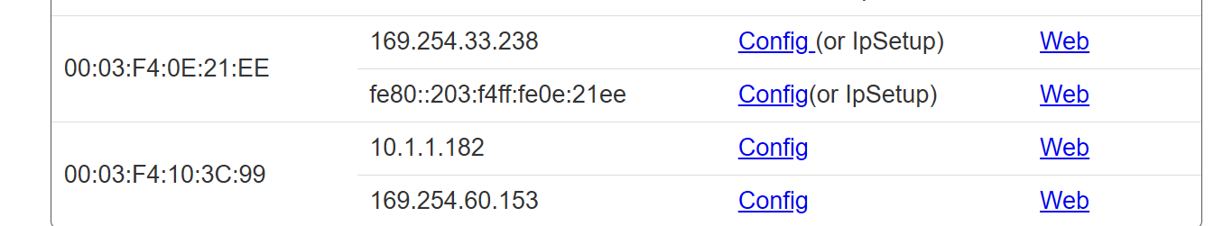

If someone uses only AutoIP, the discover server will not be accessible either, so use the localdiscover utility instead. I have attached a screen shot of my device with ending mac address of EE.
Screenshot 2024-11-26 143035.png (42.25 KiB) Viewed 203492 times

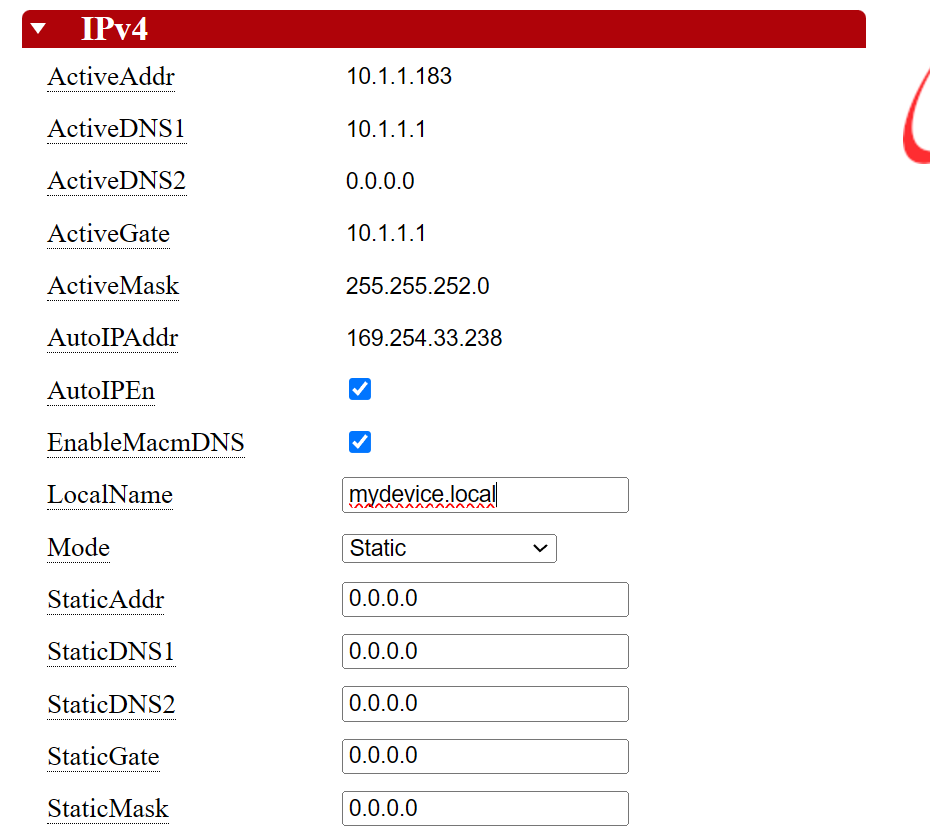

Additionally, providing that BOTH the PC and device are configured for the same local network (in this case PC is using an AutoIP address as well), you can use the LocalName option. In this case I used mydevice.local. That way you don't need to remember the IP address.
Screenshot 2024-11-26 142424.png (68.83 KiB) Viewed 203492 times
Please let me know if that helps in this case or if I missed something in the question.
