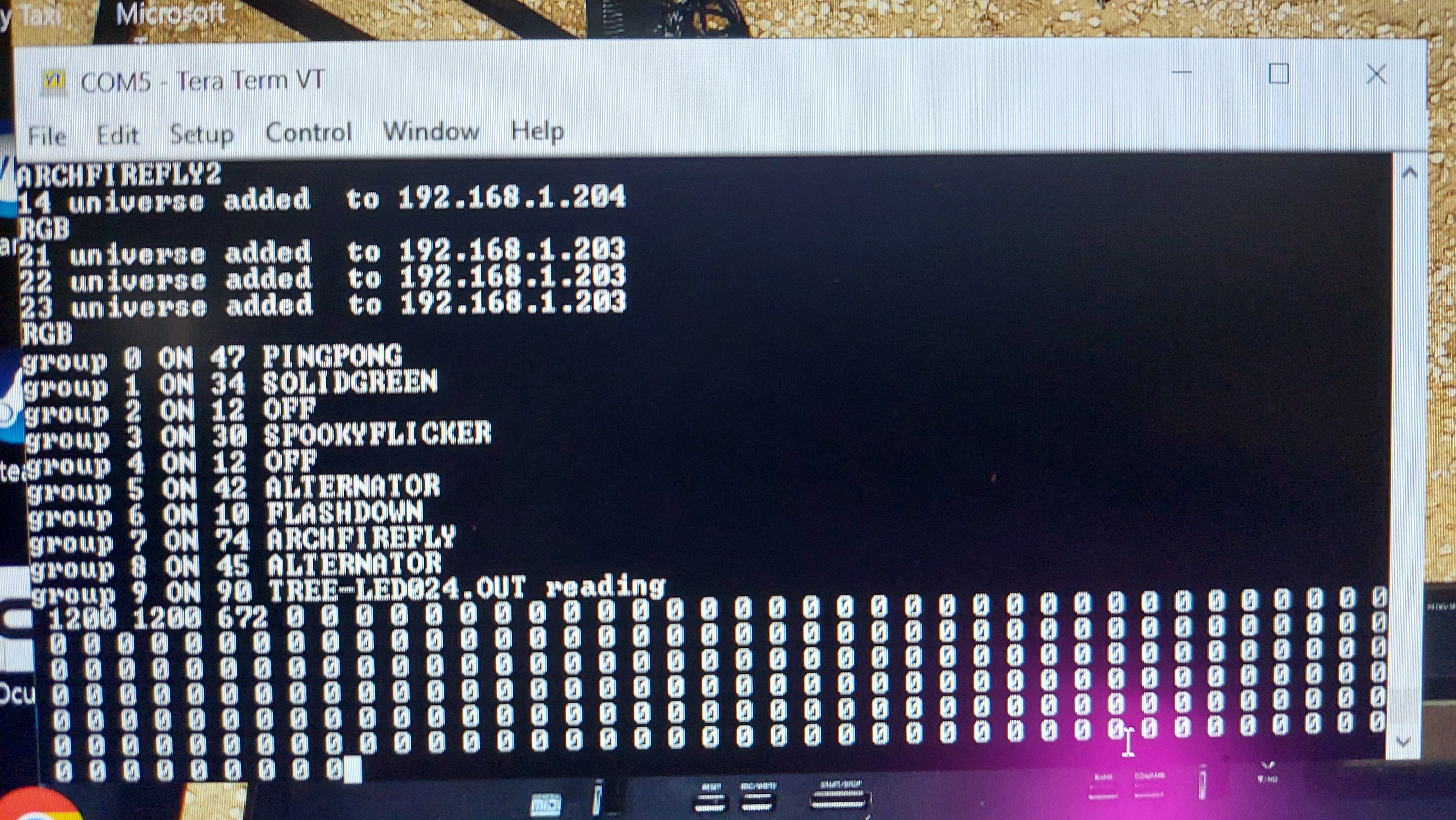

I'm guessing nobody has any idea why reading multiple times one after the other would cause the EFFS to hork?
Is there a shorting pin or other pins I should look at? Maybe something isn't connected and is floating?
*edit*
You can see where it reads 1200 bytes from the card two times, then 672 bytes, then 0 bytes forever more. The data came out and displayed fine, till the sdcard reading quit for whatever reason.
*edit*
- 20230225_164936.jpg (3.08 MiB) Viewed 40513 times
- 20230225_164914.jpg (3.65 MiB) Viewed 40513 times
Re: Problems with EFFS
It seems suspicious that it stops after reading exactly 3kb. I would wonder if there is a limit on some buffer somewhere.

Well, I stripped out everything but teh reading. I still have the same issues: It'll read 3K then nothing more.
Getting time from NTP
Time set
Starting NanoXmas2023
Seed = 1677975905
Entering SDcard
Mounting drive USE_MMC mode
FAT mount to SD/MMC successful
SD/MMC drive change successful
Entering Endless Loop
LED031.OUT reading
1200 1200 672 0 0 0 0 0 0 0 0 0 0 0 0 0 0 0 0 0 0 0 0 0 0 0 0 0 0 0 0 0 0 0 0 0 0 0 0 0 0 0 0 0 0 0 0 0 0 0 0 0 0 0 0 0 0 0 0 0 0 0 0 0 0 0 0 0 0 0 0 0 0 0 0 0 0 0 0 0 0 0 0 0 0 0 0 0 0 0 0 0 0 0 0 0 0 0 0 0 0 0 0 0 0 0 0 0 0 0 0 0 0 0 0 0 0 0 0 0 0 0 0 0 0 0 0 0 0 0 0 0 0 0 0 0 0 0 0 0 0 0 0 0 0 0 0 0 0 0 0 0 0 0 0
Time set
Seed = 1677975905
Entering SDcard
LED031.OUT reading
