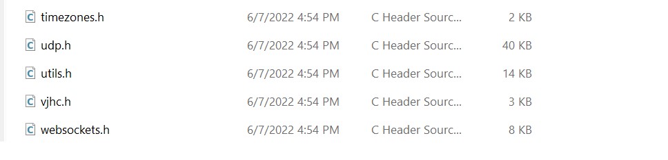

That must be put in there by the DMH installer, it is not one of our files. Here is a pic of the directory of a standard 3.x install:
Screenshot 2022-11-30 125034.jpg (30.19 KiB) Viewed 33756 times
