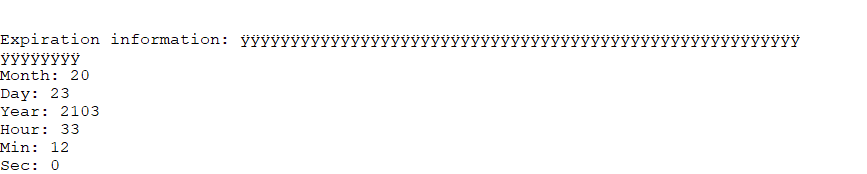

and here's the output I use your function:

I think the problem is about SSL_GetExpirationDate() since it did the job to get the expiration date of a cert.
RebootExpert
Posts: 99
Joined: Fri Oct 09, 2020 2:57 pm
Re: validate cert and private key
Post by RebootExpert »
Or is the function specific for the self generated cert use only?
