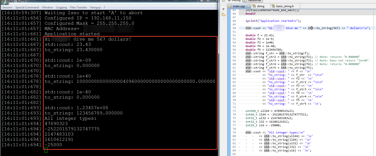

In gcc 5.2.0 compiler, by default, when trying to use std::to_string(), you get an error
error: 'to_string' is not a member of 'std'
I found that if the following defines are enabled (added to Preprocessor) in gcc-5.2.0 (nndk 2.8.x)
_GLIBCXX_USE_C99
_GLIBCXX_USE_C99_DYNAMIC
For gcc 8.1.0 (nndk 3.0.0):
_GLIBCXX_USE_C99_STDIO
then the code compiles successfully. See attached screenshot (example from cppreference).
