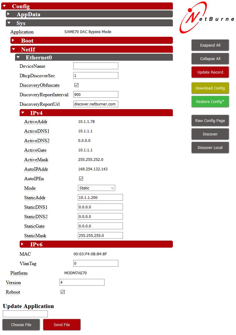

The serial config mimics the tree structure of the config web page. At any time you can type "ls" to see the next branch, or a "?" to see all the values of the current branch and those below it. The tab key will cycle through the next set of branches. Names are case sensitive. For example, type "Config" and you will go to the Config branch.
The place you want to get to is the network interface. Choose each of the branches to get to: Config.Sys.NetIf.Ethernet0.IPv4.
Now type a ? to see the current settings and variable names. For example:
Config.Sys.NetIf.Ethernet0.IPv4.>?{
"IPv4":{
"ActiveAddr":"10.1.1.78",
"ActiveDNS1":"10.1.1.1",
"ActiveDNS2":"0.0.0.0",
"ActiveGate":"10.1.1.1",
"ActiveMask":"255.255.252.0",
"AutoIPAddr":"169.254.132.143",
"AutoIPEn":true,
"Mode":{
"Choices":"DHCP,DHCP w Fallback,Static,Disabled",
"Value":"DHCP"
"StaticAddr":"10.1.1.199",
"StaticDNS1":"0.0.0.0",
"StaticDNS2":"0.0.0.0",
"StaticGate":"0.0.0.0",
"StaticMask":"255.255.255.0"
So you are going to need to set at least the IP address, mask and Mode. In the above you can see the Mode choices, and the current setting is DHCP. So type Mode to get to the Mode branch. Any branch that has choices also has a value branch. So now type Value. You should now be at:
Config.Sys.NetIf.Ethernet0.IPv4.Mode.Value>. The equal sign '=' sets a value. Type ="Static" to change the mode to Static.
Typing ".." moves up a branch. so move up to Config.Sys.NetIf.Ethernet0.IPv4>
Type StaticAddr, and set the value. For example, ="10.1.1.1"
Go up a level to IPv4, then to StaticMask and set its value
Go up a level to IPv4 again, then type a ? to verify the values are what you want
Now you need to save your modifications. You can go all the way to the top of the tree by typing a \ and enter. Now type the word save. Reboot the device for the settings to take effect. In a web browser, type the device's IP address followed by :20034 to access the config page. For example, 10.1.1.199:20034. You should see a page like the one below:
