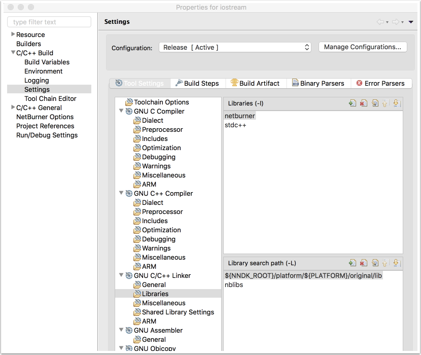

Looks like we missed the standard c++ library inclusion. While I fixed this on our side and it will be fixed in 3.0.1, you can fix it on your side by right clicking on your project and going to Properties. See included image. Basically, you need to add stdc++ as an include library.
