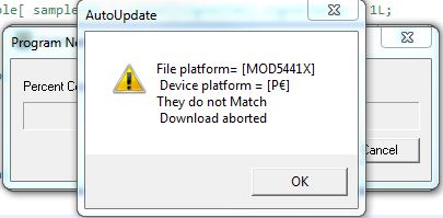

Not quite '"bricked", but *somehow* I've managed to wipe out my MOD54417 notion of what it is :shock: , as shown from AutoUpdate when I try to download a new version of the app I'm working on:
Snip of AutoUpdate Error Window
NetBurner Device Platform..JPG (23.49 KiB) Viewed 19578 times
If I use the "magic" jumper, AutoUpdate will see it just fine as "[MOD5441X]" :) , and I can download and run the program after rebooting without the jumper (although it hasn't recovered its Device platform information - the display still shows garbage - so I have to jumper and hard reset it to re-program it every time now :o :x

It does appear that I've managed to clobber the module's device ID - looking for it with IPSetup or AutoUpdate shows the 54417 module with the correct IP addresses, but with garbage (or no) characters in the device ID field for the module.
What I need is a way to restore the device ID in the application area of the module. The device ID, BTW, in the Alternate Boot Monitor is fine: "MOD5441X", which shows up as expected via IPSetup or AutoUpdate finding the module in ABM mode.

Open up the _APP.s19 you want to load with a text editor. Remove the first line and save. Load that with autoupdate. It's up to Autoupdate to verify the image and target share the same platform.
Basically, every _APP.s19 generated by compcode will embed the platform it's for at the start of the file. I believe that once upon a time this was not the case, so Autoupdate needed to be able to handle files without the platform during the transition period. Now it turns out to be a useful "feature" in situations like yours...
