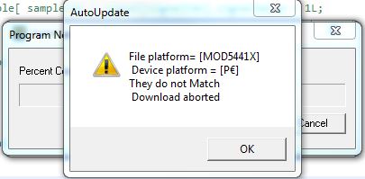

Not quite '"bricked", but *somehow* I've managed to wipe out my MOD54417 notion of what it is :shock: , as shown from AutoUpdate when I try to download a new version of the app I'm working on:
Snip of AutoUpdate Error Window
NetBurner Device Platform..JPG (23.49 KiB) Viewed 19567 times
If I use the "magic" jumper, AutoUpdate will see it just fine as "[MOD5441X]" :) , and I can download and run the program after rebooting without the jumper (although it hasn't recovered its Device platform information - the display still shows garbage - so I have to jumper and hard reset it to re-program it every time now :o :x
Is there any easy way of resetting this information? :?:
Thanks!
Ron

It does appear that I've managed to clobber the module's device ID - looking for it with IPSetup or AutoUpdate shows the 54417 module with the correct IP addresses, but with garbage (or no) characters in the device ID field for the module.
What I need is a way to restore the device ID in the application area of the module. The device ID, BTW, in the Alternate Boot Monitor is fine: "MOD5441X", which shows up as expected via IPSetup or AutoUpdate finding the module in ABM mode.
