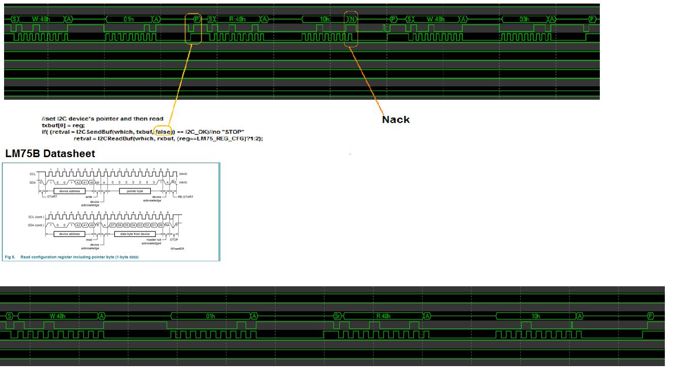

The function call I2CSendbuf(), when supplied with the argument "Stop" set to false, still issues a stop I2C signal. The particular device being addressed (LM75B temperature sensor) requires an I2C address byte PLUS an pointer address byte (when the internal pointer is changed). The subsequent LM75B read from that pointer specifies a RESTART. This seems to only be possible with low level functions. See attached for functional vs. non-functional.
I haven't seen any mention of this issue in release notes up to 2.7.3, so I haven't tried upgrading the NBEclipse NNDK.
Screen captures of I2CSendbuf() vs. Low-level function calls

Looking at the code you posted below the Logic Analyzer's output, I would guess the I2CSendBuf is doing what it should be doing then when the ReadBuf command starts, it realizes no restart byte has been sent and restarts the bus so that it can send it's own address bus with an appropriate start. The way that you have to send a restart on the bus is unfortunately SendBuf, Restart, ReadBuf, even if you set the appropriate stop bit at the end of the function. Looking at the way you wrote your code, it would be convenient if you only had to call SendBuf, then ReadBuf, but there's no variables at the moment to keep track of whether we still own the bus and just need to restart it, so you'll have to use the restart function.

mstrzelczyk
Posts: 7
Joined: Fri Sep 05, 2014 6:51 am
Re: I2CSendBuf() not honoring Stop==false
Post by mstrzelczyk »
Thank you!
