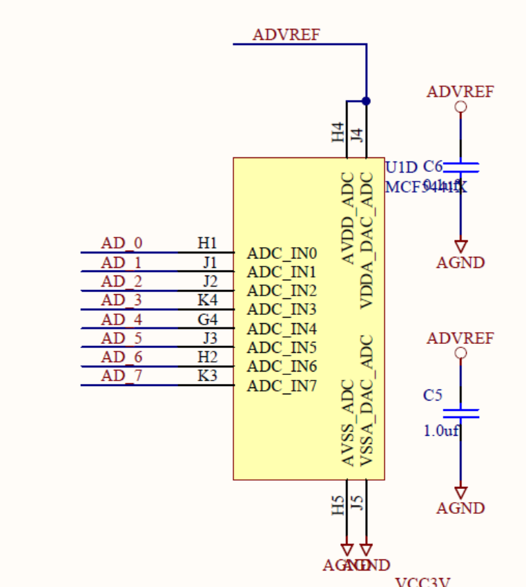

Re: Reference Voltage input on Nano54415
The nanao is pin limited. So AVCC and and reference are tied together. (We've done this on most or our products with A/D)
So Vref must be 3.3V and it must have enough current to power the analog section as its running both the VREF and the AVCC
The appropriate bit of the nano schematic is attached...
- NanoAD.png (125.11 KiB) Viewed 12913 times
