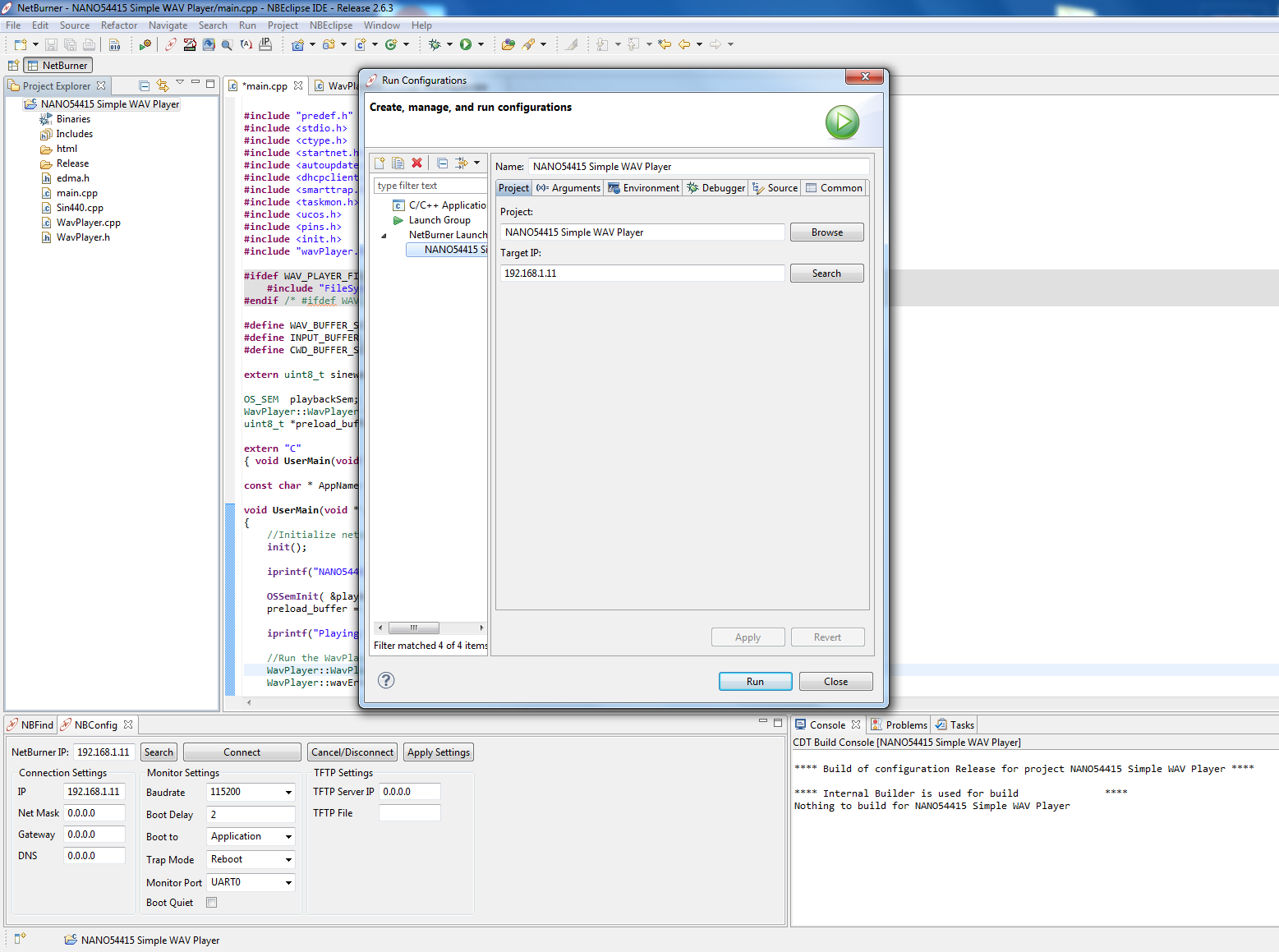

Ridgeglider, thanks for getting back with me. That is what is so damn confusing to me, all of these items/settings are correct in my project/Eclipse session. I verified that all of the configuration parameters that you mentioned are correct. When I click the RUN button I get a 'nothing to build' message (even if I change code).
Now for the interesting part - ever since I installed support for the NANO54415 I have been having strange issues with Eclipse. Just today I have now observed that my recent project on the MOD5282 is now throwing errors where there were no errors previously.
UGG!!!

I'm going to go out on a limb: take a close look at the directory name for the simple wav player, or rather the 'simple_wav_player'. I believe you're getting caught by Windows' incredibly crappy command line (NBEclipse launches tools essentially via the command line). Your project has spaces in the name, hence spaces in the directory name, hence spaces in the arguments to GCC/other tools. I don't think GCC/other tools are seeing the right directory for your project and hence are screwing up. As a general rule, I'd recommend against ever using spaces in directory names in Windows for this reason. (*NIX is much better about being able to properly escape spaces in the command line.)
Re: NAN054415 Program Upload Issue
Based on the project settings in your screen shot I'd totally agree w/Dan. No spaces are allowed in the entire path, or in any project names!
