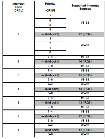

3) IRQ vectors 1-7 are considered EXTERNAL and therefore fixed, while vectors 8-63 are INTERNAL and programmable in terms of LEVEL and PRIORITY. The EXTERNAL (1-7) IRQs are fixed at their designated levels: (eg vector 1 is level 1, vector 2 is level 2, etc). Further they are fixed at a priority between 3 and 4. Any values assigned to LEVEL or PRIORITY for IRQ 1-7 is ignored. The Priority for these vectors is fixed to "Mid" at "3 or 4" although I have never been fully comfortable with what that "mid" priority means exactly. A long time ago 'yevgenit' made a useful post to this forum pointing out the following table in the MCF5275 Refe Manual saying that it was unfortunately not included w/ the 5270/1 manual:
http://www.freescale.com/files/32bit/do ... pdf?fpsp=1". I've included the table at the bottom and I think it communicates pretty well what that "middle" priority might mean???
4)Precedence: an IRQ w/ a higher level always gets serviced before an IRQ of lower level. So IRQ7 always takes precedence over others (hence its non-maskable status), IRQ5 over IRQ3, 3 over 1. See answer #1 above regarding the priority settings for IRQs of the same level.
IRQ Level and Priority Table for MCF5275.png (32.89 KiB) Viewed 8884 times

I don't think setting the Level and priority for the IRQ1 does anything since they are fixed, but I've set my PIT to Level 1 and priority 0 and still I see on the oscilloscope a variable delay between the trigger and the execution of IRQ1 which I don't see on IRQ3, IRQ5 and IRQ7. The delay is removed if the PIT is not set up so it seems to be the culprit, I think what is happening is that sometimes the PIT is running and IRQ1 can't seem to be able to interrupt it while the others IRQ can.
Re: PIT interruption by IRQ1 (EPORT)
The delay in the PIT IRQ execution you're seeing on the scope seem plausible since it is set up at the same IRQ level (ie 1) as your IRQ1 ISR, but at lower priority (ie 0) than the 'fixed' level=1 and priority = "3-4" that IRQ1 will be forced to. In other words although you spec'd level 7, and priority=8 for the IRQ1 routine, note that they it will be forced to a level of 1 and a priority of "3-4".
I'd suggest either increasing the level (above 1), or the priority (above 4) of the PIT IRQ so takes precedence over IRQ1.
Note however, that an IRQ using the external IRQ1 vector 1 will never have priority over higher IRQs. From your opening statement, this may be a design flaw. If you want the external IRQs to have precedence over the PIT, assign the PIT to level one, and then use the external IRQ3, 5, and 7 pins. Note that the IRQ7 pin is handled quite differently than all other IRQs. If you have not seen it, take a look at http://www.netburner.com/component/docm ... rm?Itemid=
One other thing to be careful of is to insure that in the INTERRUPT( Addr_of_ISR, 0x2n00) call that the, 'n' must not be lower than the LEVEL specified in the corresponding SetIntc() call.

As I mentioned, IRQ1 will be forced to level 1 and priority of '3-4'. Accordingly, you should be able to assign a lower precedence to the PIT IRQ by configuring the PITIRQ to level 1, and priority 0, 1, 2, or (maybe ??) 3 depending on how exactly the IRQ1 forced priority of '3-4' works. I think this should work.
Rather than use IRQ1, use one of the timer inputs in capture mode, that way you can set any priority you want ...
(Including 7) , the IRQ1, is indeed fixed to level 1.

This is one of those asteric data sheet items that is not at all obvious....
IRQ1 is Level 1, no matter what value you set in the interrupt controller.
IRQn is Level n, no matter what value you set in the interrupt controller.
I've taken to using timer inputs when I can as the levels are setable, and if I'm really trying to measure some kind of timing the timer capture is nice as well.. much more accurate than IRQS..
