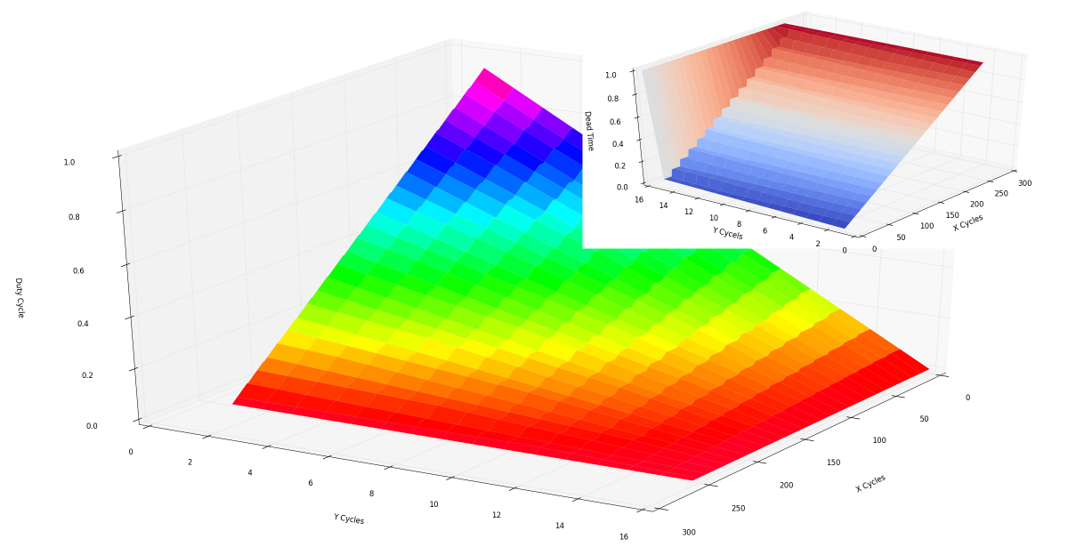

PlotDutyCycles(x_max, y_max):
    Creates a plot of the aggregate duty cycles and the deadtime for the
    given input periods.

    def PlotDutyCycles(x_max, y_max):
        X,Y,Z,D = CalcDutyCycles_surface(x_max, y_max)
        fig = plt.figure()
        ax1 = fig.add_subplot(111,projection='3d')
        ax2 = fig.add_subplot(222,projection='3d')
        surf1 = ax1.plot_surface(X,Y,Z, rstride=1, cstride=10, cmap=cm.gist_rainbow, linewidth=0)
        ax1.set_xlabel("X Cycles")
        ax1.set_ylabel("Y Cycles")
        ax1.set_zlabel("Duty Cycle")
        surf2 = ax2.plot_surface(X,Y,D, rstride=1, cstride=10, cmap=cm.coolwarm, linewidth=0)
        ax2.set_xlabel("X Cycles")
        ax2.set_ylabel("Y Cycels")
        ax2.set_zlabel("Dead Time")
        plt.show()
