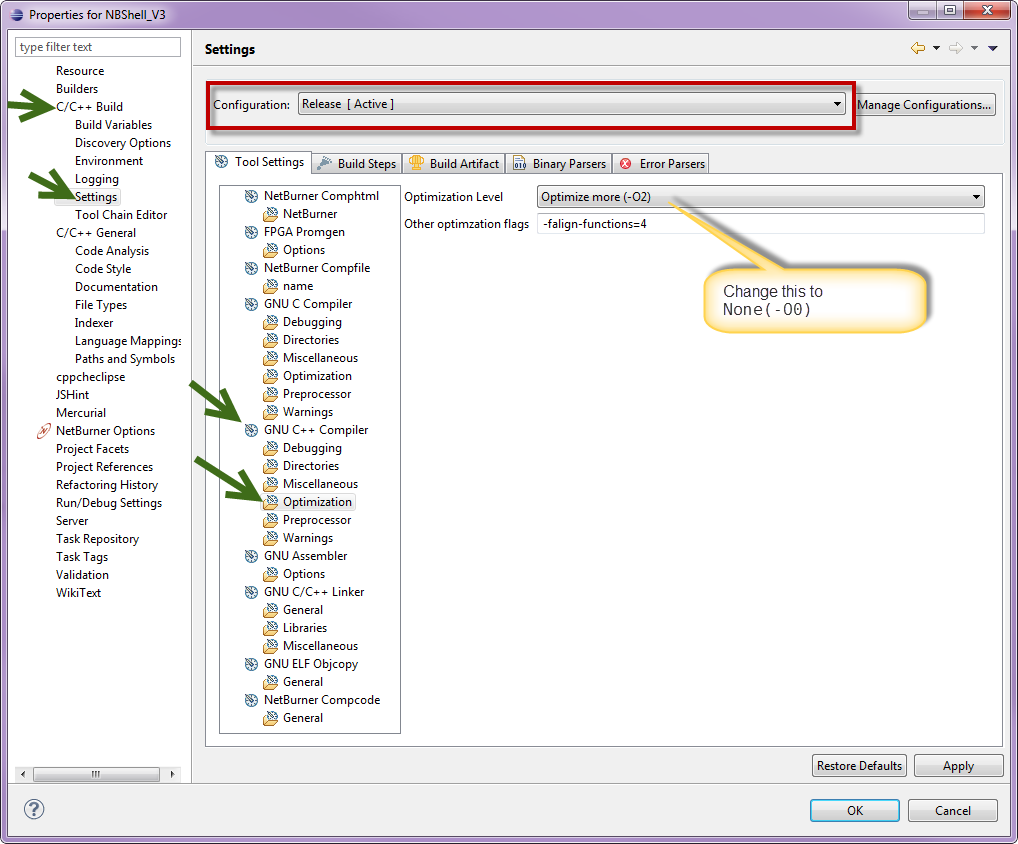

I also just noticed you said it went away in debug mode. That points to optimization problems. You can narrow that down by changing your release build to use None -O0 (see the attached image if you're not familiar with doing this). If the problem goes away it's an optimization bug.
- Optimize.png (115.83 KiB) Viewed 15559 times
