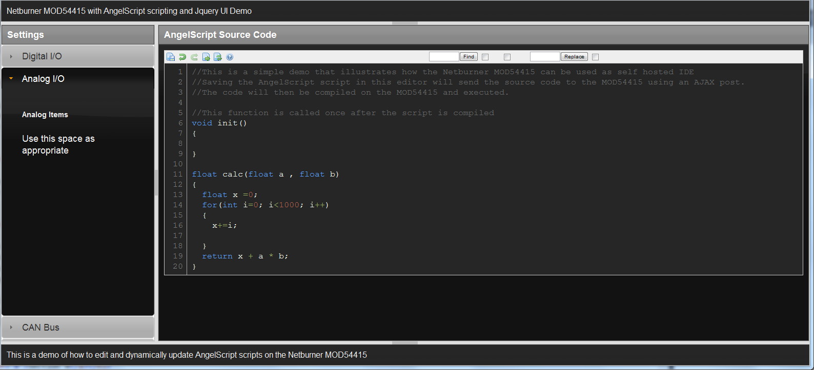

I am nearly finished a proof of concept single page Javascript web application for the MOD54415. It is a self hosted AngelScript IDE that posts the script source code using AJAX then compiles and runs it on the MOD54415. It's working pretty good. I just ran into the code size limit which appears to be solved with your suggestions. I'm in between projects right now and wanted to see what the MOD54415 was capable of. It's been pretty fun. The increased memory makes applications like this possible. I will post the example when I'm done if there is some interest. This is a screen shot of the web app.........
