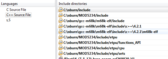

The project build paths are below. What's odd is that for some reason, some other projects in the same workspace with the same #includes don't show codan bug errors for the OSDumpTasks() and OSDumpTCBstacks() calls. Any ideas to prevent them??

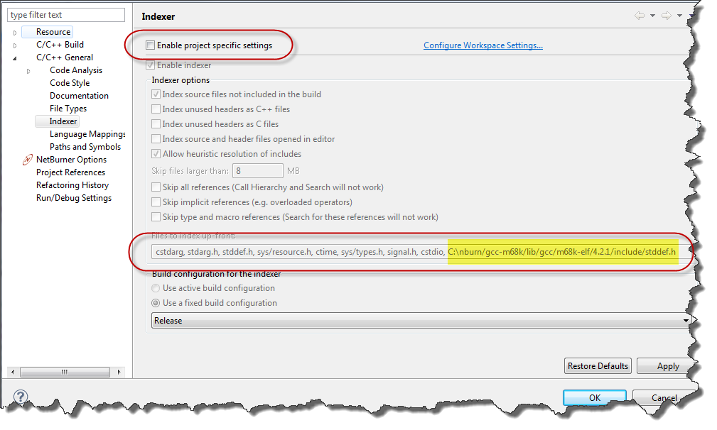

Is it possible that for this project under the properties C/C++ General->Indexer settings you have the Enable project specific settings check box checked? Also it would help to see the line from that same indexer settings for the Files to index up-front: text box.
Edit: Oh yeah you also probably want to right-click the project and do an Index->Rebuild if you haven't already.

1) I believe a related problem may be that for some reason codan is also once-again placing the bug icon on anything that has an argument of size_t (usually sniprintf() or snprintf() calls). I thought I'd fixed this last week by following your StackOverflow post as highlighted in yellow below in the Files to index up-front: box.
2) As you can see, the Properties >> C/C++ General >> Indexer tab "Enable project specific settings" is NOT checked.
3) Yes, I did rebuild the index as suggested.

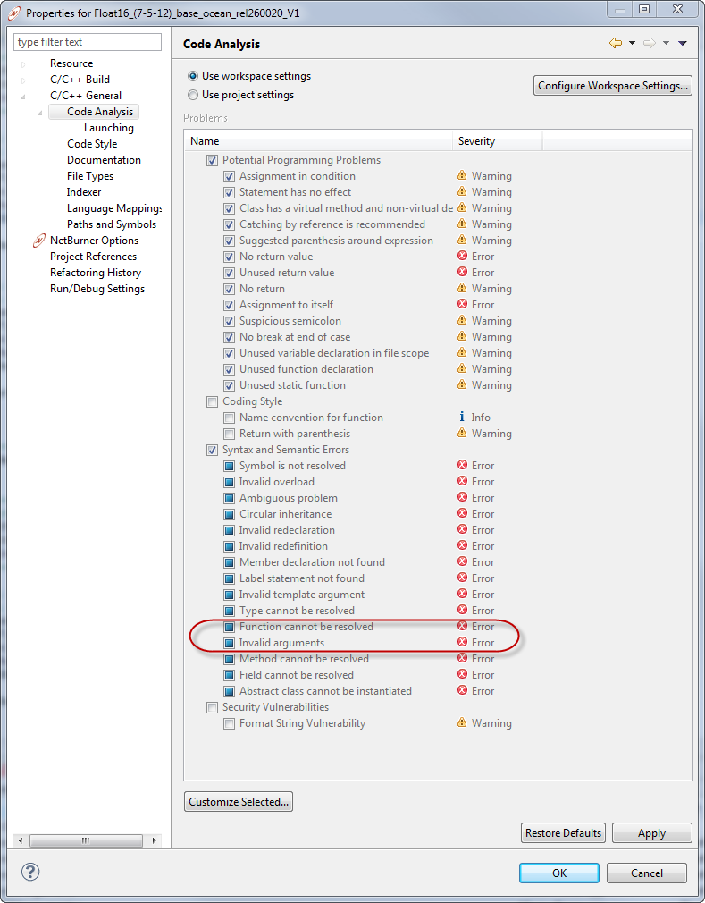

4) If I uncheck the circled items in the Codan settings, these errors don't show up,k but I'm learning that the codan output is really useful if i can just get it configured properly...
