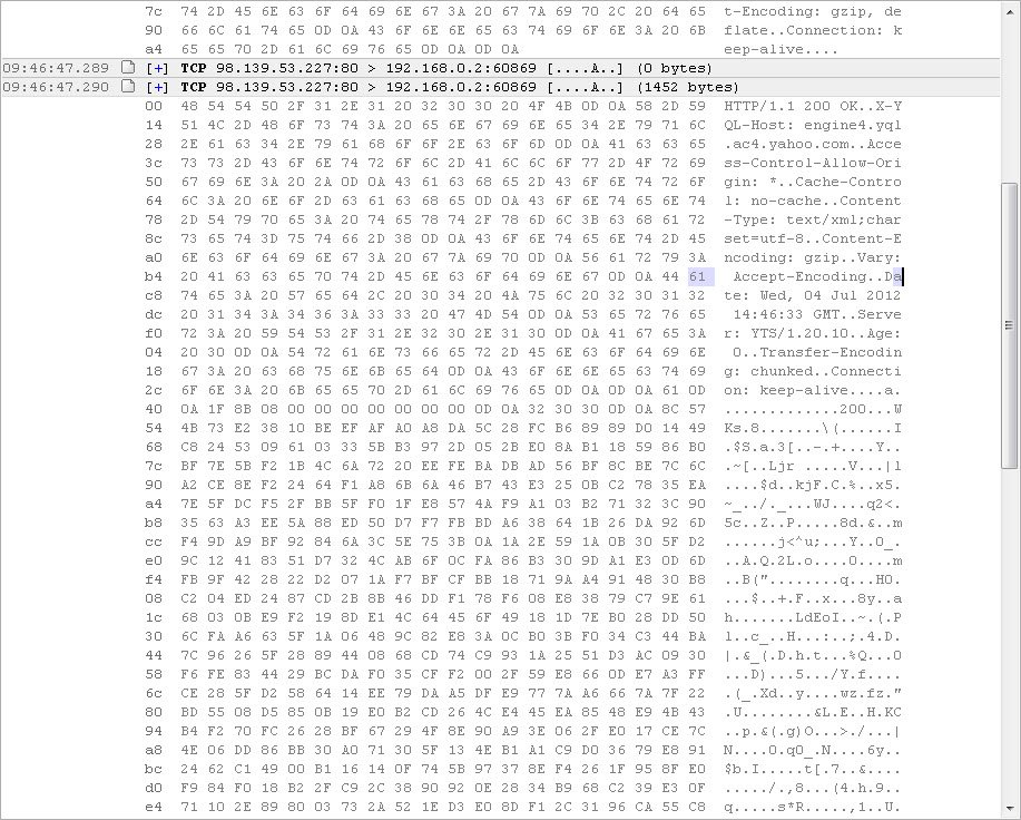

Hi Dave. More research on this turns out that the data is gzip. The response header is as follows.
the interesting part here is the "Content-Encoding: gzip" because after this header information the rest of the data is just gibberish.
Here is the screen shot of the response.
- 7-4-2012 9-54-34 AM.jpg (214.97 KiB) Viewed 11346 times

Ah ok. It would appear that the browser is extracting the gzip file which seems a little strange as normally it should ask if I want to save this type of file so I guess this must be an internal browser method of handling data.
The gibberish is obviously the zipped data so looks like you need a library or such to unzip the data.

ya, that link in the first post is using YQL to get stock data. But to my knowledge there is no way to tell it not to gzip the response.
the only options are XML and JSON but both are gzip'ed

FWIW, this is what i did and now life is good again.
If one looks at the GET message sent to the server is this:
If one simply changes the "Accept-Encoding: gzip, deflate" to "Accept-Encoding: gzipdeflate" this will make the server not respond with gzip data.
