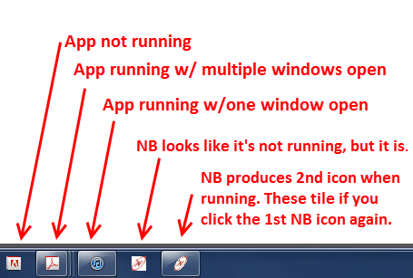

On another note: I've noticed that 2.6 behaves a little oddly on the Win7 64 taskbar. I run NB eclipse from a shortcut (allowing it to run as administrator). The shortcut is on my taskbar. When most of these taskbar icons are pressed to run the associated program, the icon changes to a square shape indicating that the program is running. These squares 'tile' to indicate multiple windows of the associated app. In pre-Rel2.6 releases. NBEclipse worked this way. Now however, it creates an additional tile. It works, but it's a little odd.
NB Taskbar icons.png (25.86 KiB) Viewed 5299 times

That is strange about the taskbar issue you have. I am running 2.6.020 on Win7-64bit and it does not do that on mine.
Re: Rel_2_6_0_020
Interesting... I see the taskbar behavior on two win7 64 PCs...?

Under win 7 ultimate 64 running a 32 bit version of Indigo my task bar behaves properly.
