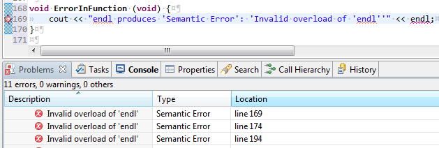

Hi guys. At long last I'm taking Tod's advice to eliminate printf in favor of cout. it's working nicely but the codan module in Rel_2.6.020 seems to be telling me that my usage of endl is a 'semantic error' with the following code and includes configured. The file starts with:
using  std::string;
using  std::cout;
using  std::endl;
using  std::cin;
if instead I say:
using namespace std;
I get an error telling me 'std' is ambiguous, and endl throws the same errors.
Finally, in either case, even though these "bug icon" errors are flagged, the code builds successfully. What do I need to do to make endl tolerated?
Here's the code and the error:

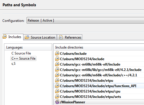

I don't have this problem and the only difference I see is one include path you don't have. (You also have one I don't have but that shouldn't cause a problem but just in case, attached is an image of the three gcc-m68k includes I put in every project.
