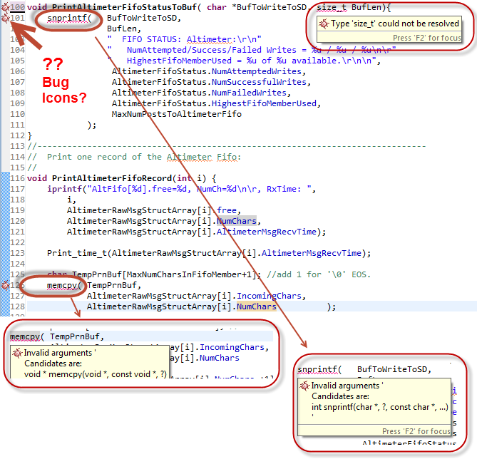

I'm importing a project that worked in previous releases to a workspace running under Rel_2_6_0_020. The project builds successfully. However, when I open files that use size_t in either a function declaration, or as an input parameter to a function, I get a new bug icon messages that 'size_t' could not be resolved. The file with the problem code #includes <stdio.h> so size_t should be recognized. Other functions like snprintf() and memcopy() that take an argument of type size_t also produce the bug icons and produce a '?' character in the hover box in the position of that parameter.
Several questions:
1) What's the new bug icon all about?
2) why isn't size_t recognized?
3) If it isn't recognized, why is the build successful?
Any thoughts?

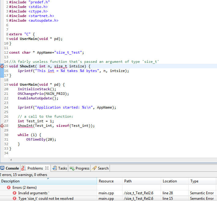

Here's a really simple, almost AppWiz-generated bit of code that exhibits the problem with size_t when it's used in the arguments in a declaration, or in the parameters passed to any function expecting an input of type size_t. The code compiles under 2.5.3, and the new Rel_2_6_0_020 . However, no errors are reported for 2.5.3, while two are reported for Rel_2_6_0_020. That's odd, because in Rel_2_6_0_020 the console reports a successful build despite the presence of 2 errors. (2.5.3 reports none.)
Finally, the error locations are immediately indicated by new 'bug icons' that appear as soon as 'size_t' is typed and even before a save is done. Maybe, as Tod suggested this is part of the Code Analysis that's available as I previously reported?
Last but not least, it's worth mentioning that size_t is declared in stdio.h, which in turn is #included in this code.
Here's the code:

and a screen shot of the bug icons and the errors...:

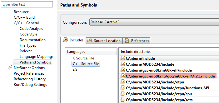

Tod: Your stackoverflow post did the trick thanks! I owe you a beer (probably several by now)!
Forrest: I like the Code Analysis feature!!
The only thing I changed from the stackoverflow post is:
C:\nburn/gcc-m68k/lib/gcc/m68k-elf/4.2.1/include
instead of
C:\nburn\gcc-m68k\lib\gcc\m68k-elf\4.2.1\include\stddef.h.
Not sure what the deal is with / vs \ but I just copied the default format used for the other paths...
Finally, is there any way to make this addition to the path be the default for all projects?

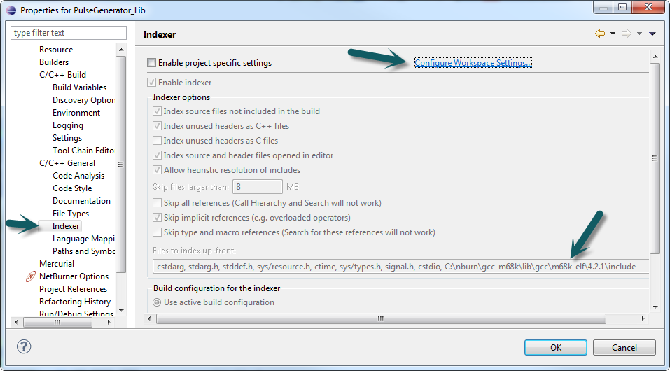

BTW - where you added the path didn't work for me when I had the problem I had to go up to the Indexer setting and set it there. If you click on the Configure Workspace Settings... it let's you set it for all your projects in the workspace.
Screen shot of Indexer settings

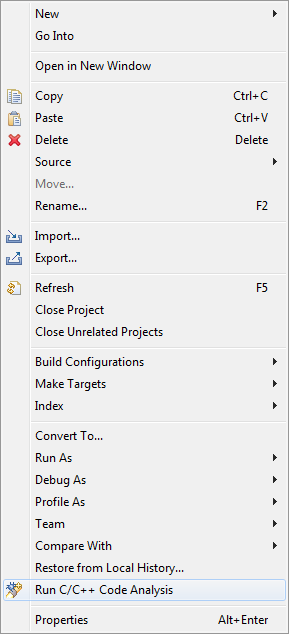

Also once you change preferences for Code Analysis you have to make a change for it to rerun. Alternately when you open a file it appears to run code analysis. You'll notice it puts little icon overlays over files in the Project Explorer. Using the right-click menu on the project and using the Run Code Analysis shown in RidgeGlider's post will cause the analysis to be run on all files. I turned off the setting for requiring parentheses around return statements and all my little yellow marks went away. So it's a convenient way to clean things up fast.
