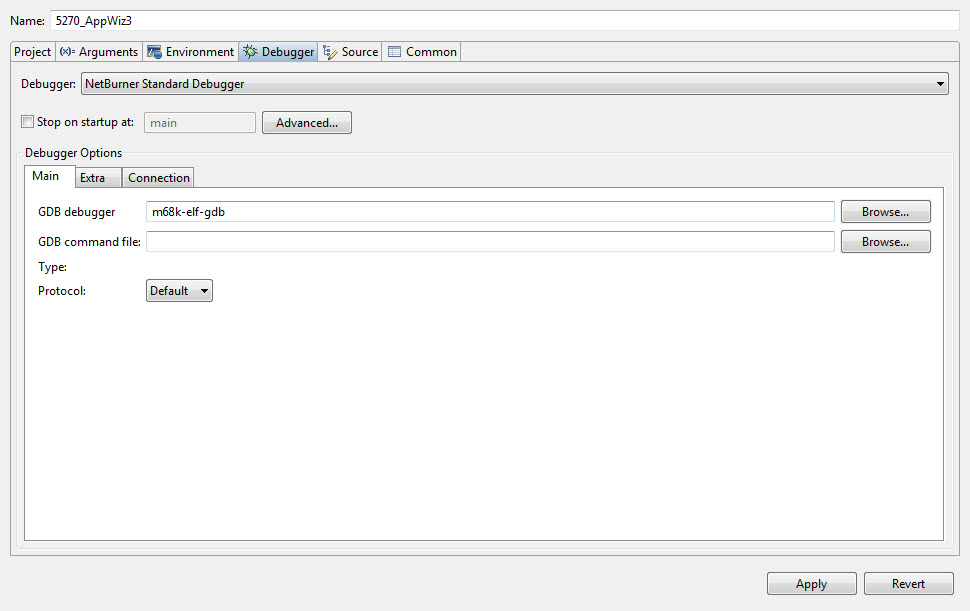

Forrest: Here's another issue. I thought I'd posted it earlier, but I guess not. In the PC version of Rel Rel_2_6_0_010, unlike other recent releases, when you create a run configuration, it has become necessary to enter the debug executable "m68k-elf-gdb" into the GDB debugger field on the Debugger tab of the run configuration dialog boxes:
- Run_Config_Dialog.jpg (79.64 KiB) Viewed 8242 times
