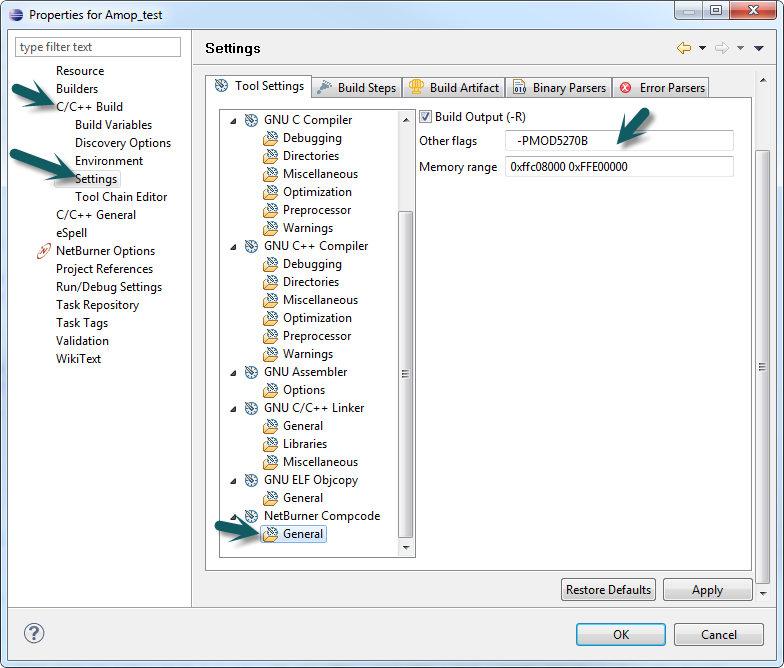

Re: Mod5270 & MOD5270B with v2.5.3
If you want to user greengene's solution with the Eclipse automated build you can add a flag to CompCode using the General tab and then typing the desired value in the Other flags text box. Adding -PMMOD5270B won't remove or replace the board flag already there. Moving up to the NetBurner Compcode level will show you the final command line being used for compcode. (I tested adding the flag but not actually doing a build to see if it works with both boards).
