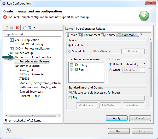

Got a new set of beta 2.6.0 plugins today and they work GREAT! Kudos to NB and Forrest for getting this working. I was able to create and test run configurations today with no problem. I tested the 5270 and 5272 factory demos. Codan flags a few lines which I fixed and no problems from build to running. I then ran several of my own projects through the process. The Run configuration dialog has a new launcher area "NetBurner Coldfire Launcher" and using this worked flawlessly. I got an error message about the configuration not supporting source lookup but it didn't adversely affect the process. I'm moving onto Indigo as my development platform. I'll post if I find any show stoppers.
