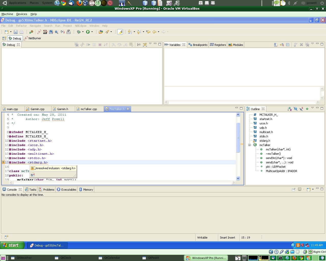

How do you get around the "Unresolved inclusion" error in the nbeclipse?
Error on screen.
Error on screen.
Chris Ruff
Posts: 224
Joined: Thu Apr 24, 2008 4:09 pm
Location: topsail island, nc
Re: vsprintf question
Post by Chris Ruff »
Ah, eclipse
I'm sorry, I don't use eclipse, but I am supposing that there is a menu entry for include subdirectories that you would specify:
\nburn\gcc-m68k\lib\gcc\m68k-elf\4.2.1\include
or the other c++ path where it is found
you may have a different version - not 4.2.1
search \nburn for stdarg.h
eclipse may require forward slashes, I don't know
good hunting
Chris
Real Programmers don't comment their code. If it was hard to write, it should be hard to understand

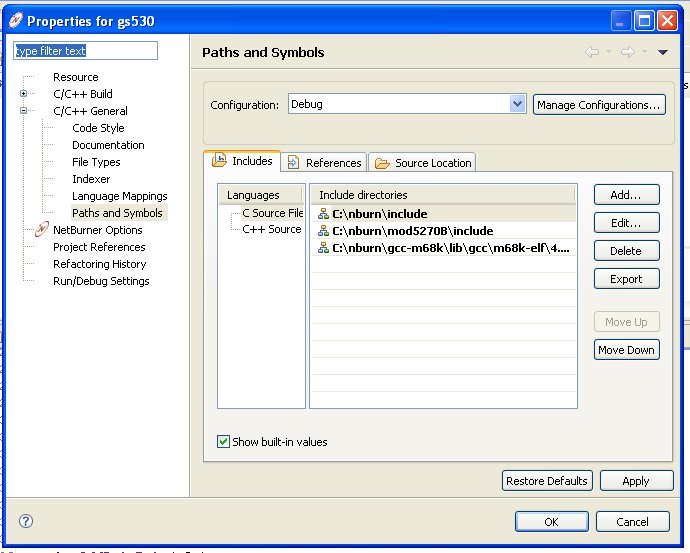

Here is the screencap from my paths. I did this earlier when I got rid of the inclusion error.
The paths pointing to the stdarg.h
