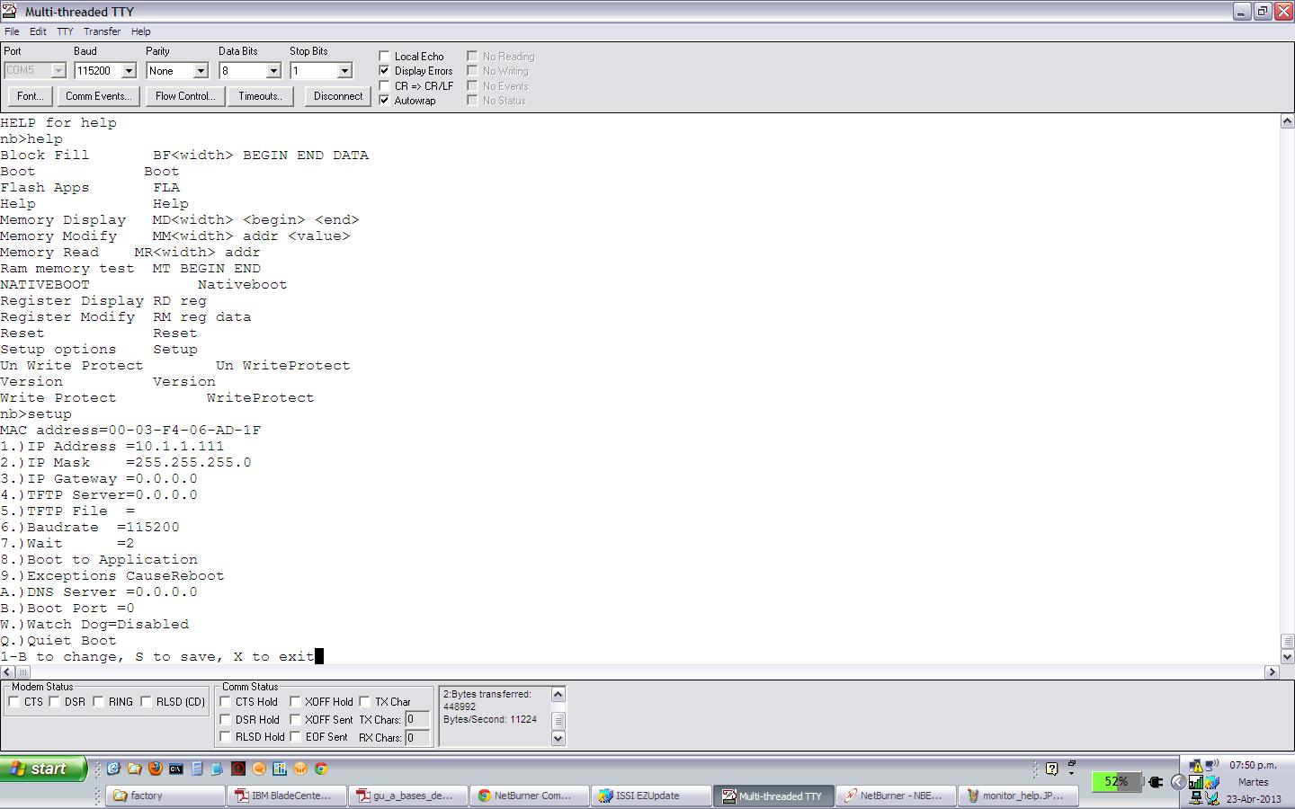

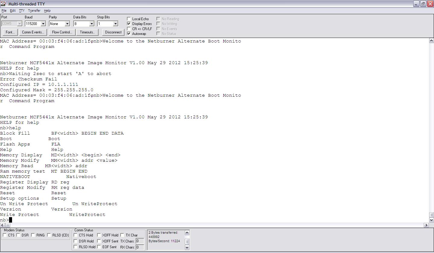

Ok, I tried the alternate monitor by shorting the tp1 jumper; while in the alternate monitor, which perfectly runs, I tried to use the Autoupdate tool. I can use IPsetup to set the net parameters of the module and it also works ok. However, I am not able to upload any program using the Autoupdate tool, it returns an error due to time out ("Programming Failed with timeout").
Again, I tried downloading a program using the monitor using the FLA command. After the transfer is complete, the monitor writes ¨cheksum fail¨, and everytime I reboot the module it will show the checksum fail print and run the alternate monitor.
I attached two pictures of the prints from the task monitor, after the help and then the setup commands. In the monitor_help you can see the check sum failed print I am talking about.
I really need some insights on this issue please, since I am not able to test any program.

Re: Checksum fail
Several questions...
what are you trying to load?
you should be loading the xxxxx_app.s19
not the xxxx.s19.
If you try and load the bare s19 you will get the results you indicate.
Also is this plugged into one of our dev obards, or your own custom hardware?
If its plugged into your own custom hardware you may be clobbering the data bus lines used to read the flash.
not the xxxx.s19.
