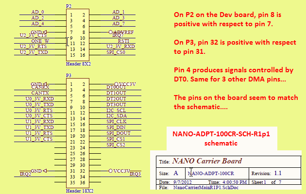

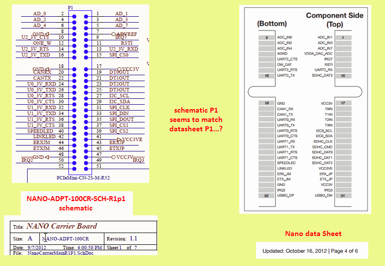

Dan: not sure I'm seeing the mis-labeling on the Nano headers. Here's what I see for the Nano edge connector (1st image), and then in the P2 and P3 headers (2nd image). The P1 schematic agrees w/ the datasheet: eg Pin 1 in Dev Board schematic schematic is the same as pin 1 in data sheet. I have not checked the edge connector itself, so maybe that's what is mis-labeled in both schematic and data sheet although, since you mentioned the headers (P2 & P3??), I don't think those are the pins you are suggesting that are backwards.
Next, as indicated in the 2nd image, the Dev Board P2 and P3 headers also appear to be properly labeled: P2 and P3 on the Dev Board both match schematic. These check out when testing the actual Ground vs 3.3V supply pins, (3.3V is positive wrt Ground). Additionally, all the pins labeled as P3 DT0-3 pins work as expect with DMA IRQ code. Bottom line: still not sure what pins are "backwards'??
With regard to getting traps for the DMA timer, I see no evidence of that either. My code builds on IRQs for each channel, pretty much like what's shown in the C:\nburn\examples\utils\HiResTimerDemo\HiResTimer.cpp Nano54415 section for setting up the INTERRUPT() and SetIntc() routines.
- Nano 54415 P1 pinouts schematic vs datasheet.gif (48.62 KiB) Viewed 20416 times
- Nano 54415 P2 and P3 pinouts schematic vs datasheet.gif (24.18 KiB) Viewed 20416 times

Hmm... maybe we did make that silk screen change. I know that the actual labeling on my dev board (and at least one of the other engineers') at the office (rev 1.1) has the P2 and P3 headers mislabeled. It has the Even pins on the outside of the board and the odd pins on the inside. I'm not saying this to try and confuse you, but to give you a heads up if things don't seem to hook up correctly.

Regarding pin labeling on the Nano Dev board: My board is rev 1.0. The schematic is R1.1... Hmm.
Is there a rev 1.0 schematic available? There seem to be a couple of jumpers: JP8 (to disconnect ADREF from VCC3V) & JP9 (to allow disconnection of USB_Rx)added between R1.0 and R1.1. These are pretty self-explanatory, although my R1.0 board does not have those jumpers. Still, a schematic would be... convenient in case there are other differences.
The P2 and P3 pins are labeled w/even numbers on the board edge....
I thought i was OK (and things seem to work), but am now a tad confused on what I should look out for.

There is not a rev 1.0 schematic available. The differences between rev 1.0 and 1.1 is the tx/rx line fix (which you probably have as greenwire) and adding those jumpers.
With regards to the pin numberings, I think I was unclear. The silkscreen says that the even pins are on the outside and the odds on the inside. Electrically the odd pins are on the outside and the even pins are on the inside. The silkscreen on the rev 1.0 and 1.1 dev boards is incorrect and has them flipped.
