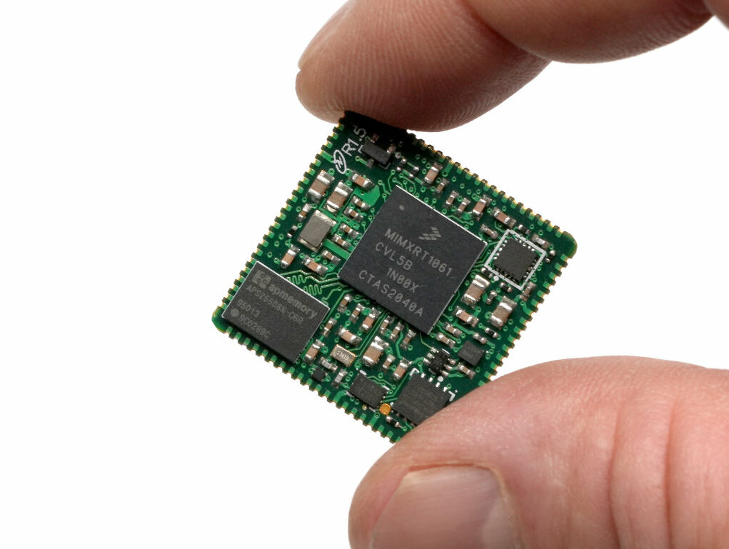

If you are upgrading the entire product due to the EOL, then the new SOMRT1061 would be a choice as well:
https://www.netburner.com/products/syst ... somrt1061/
