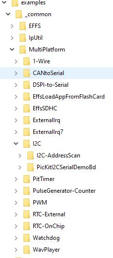

Re: MOD54415 I2C
I'm not sure if you saw my earlier post. The common platform examples are located at: \nburn\examples\_common\MultiPlatform\I2C. Since it is the same code for MOD5441x, NANO and SB800EX, we want just one set of files for the example so any future updates don't get missed on a specific platform. Please let me know if you are able to find the I2C example in the _common directory.
The attachment common.jpg is no longer available
The ReadMe.txt file specifies which platforms are supported. In the I2C scan example:
Scan the I2C bus for devices and display their addresses.
Supported Platforms: MOD5441x, NANO54415
ScanI2CBus sends out a request on the I2C bus and waits for an ack, scanning each address
in the address space.  If a device responds, the device address is reported.
If you look at the example folder in the docs, rather than the _common folder on your drive, it puts them in a section for multiplatform as shown below. The only examples in the platform specific nano folder would be examples that can only run on a nano and no other platform.
Here is a link to the section in the online docs
https://www.netburner.com/NBDocs/Develo ... group.html
Please let me know if that helps clarify things. We have a significant number of examples and are working hard to try and make them easy to locate, but also avoid missing any updates for any specific platform. Grouping the common ones is one way to ensure we don't miss a bug fix or added feature for any platform.
