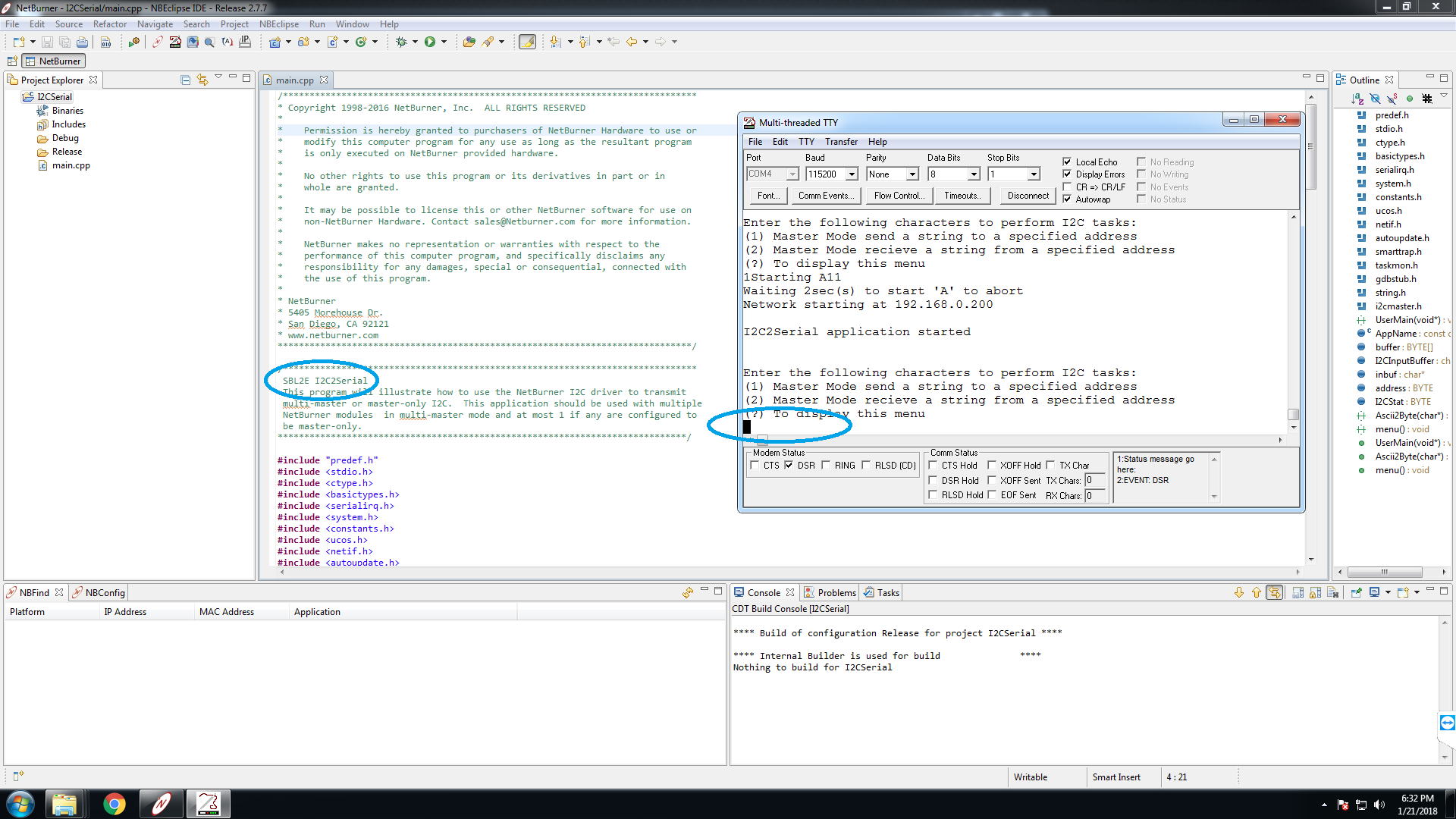

I am having an issue with typing commands into the MTTTY console. I am using the example code with no modifications. The issue I am having is when I try and type in commands into MTTTY nothing happens. Is there something obvious I am missing or have overlooked? I have attached a screenshot of the example code I am using and the MTTTY UI.

Are you using USB or the DB9? If using our development board you need to set the jumpers so the serial input is routed correctly (transmit will always be sent to both). The jumper settings are described in the quick start guide for the kit.

TomNB wrote:Are you using USB or the DB9? If using our development board you need to set the jumpers so the serial input is routed correctly (transmit will always be sent to both). The jumper settings are described in the quick start guide for the kit.
Ah, yes. That was the issue, I figured it was some kind of simple oversight on my part. Thank you!
