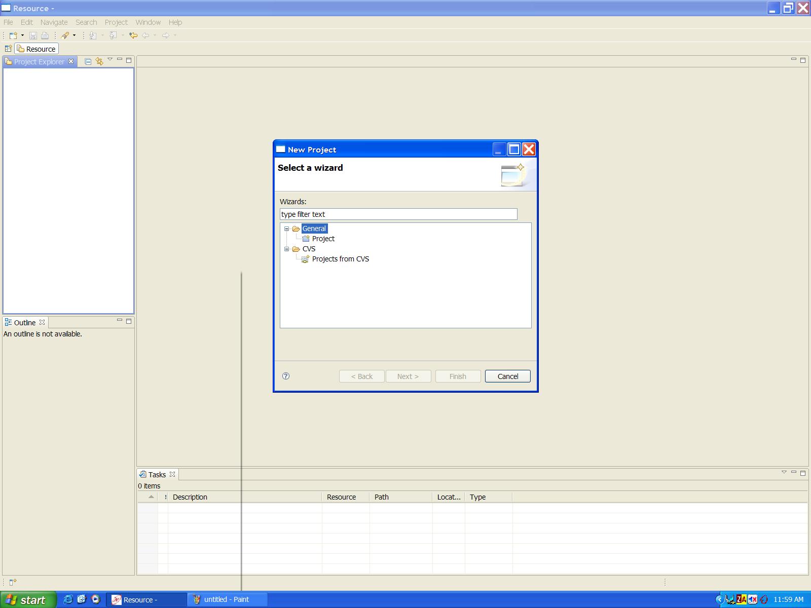

Hi, I am having problems installing NBEclipse. Looks like I am missing something for my installation. When I start a new project, I just can't find the C/C++ or netburner project in my wizard.
Here is a screen shot. Anybody know what is going on there?

What version of java are you running?
What version of the dev. tools are you installing?

My java is JAVA2 Runtime environment SE v1.4.2
Netburner is Release24_RC2.
I tried to install Eclipse
Re: NBEclipse installation failure
Eclipse requires that you have Java release 1.6 or greater to run. Update your java release and then reinstall the NBEclipse application and it should be fixed.

Thanks, Forrest and rnixon.
That solved the problem. Everything is working fine after I upgraded Java. It is just a old laptop.
