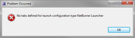

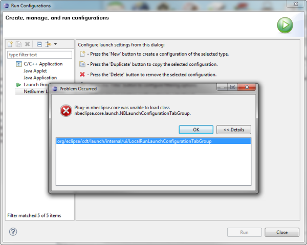

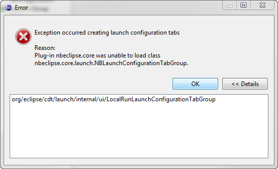

Has anyone gotten the NetBurner plug-ins to work with the latest Eclipse Helios release? I'm trying it under Windows 7 with the 64 bit version of Helios. Most of the it works, but the ability to set a target platform doesn't seem to work from either the Project Properties or when setting up a run configuration. I can get existing projects to compile, just can't run them with the Run menu.
Using it from the Run configuration results in this dialog

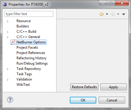

When using the Project Properties and selecting NetBurner Options, the panel just remains blank.
The normal trick of just moving to a different setting and them coming back to the NetBurner options isn't working. I've been unable to ever see the options. Nothing too critical about using Helios versus Galileo, just always looking to stay current.

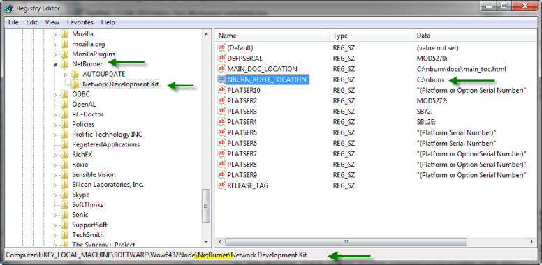

Check your registry. Do you have the folder HKEY_LOCAL_MACHINE\SOFTWARE\NetBurner\Network Development Kit with key NBURN_ROOT_LOCATION? And if so, does it point to you c:\nburn directory (if thats where you are installed). If you do have all this, I wonder if this is a win7 registry permissions issue.

No I don't but I do have a key called
HKEY_LOCAL_MACHINE\SOFTWARE\Wow6432Node\Network Development Kit with key NBURN_ROOT_LOCATION that points to my installation (G:\nburn).
I'm running Vista 64.
Sam

I have the key but I also have the "Wow6432Node" folder before the "NetBurner" folder, here's a screenshot (serial numbers were erased), you can see the full path in the status bar. I'm running Windows 7/64 bit. The Wow6432Node directory is used for 32 bit apps. Since I installed the 64 bit version of Helios I suspect that this directory is not getting read in Helios but only from the 32 bit install of Galileo.
Re: Can anyone Get Helios working?
The obvious experiment is to add a windows registry key without the Wow6432 etc... in the path.
IE add the Netburner links in the apropriate place.
Eclipse uses this "root" location to scan for installed platforms, so it sort of all makes sense.
