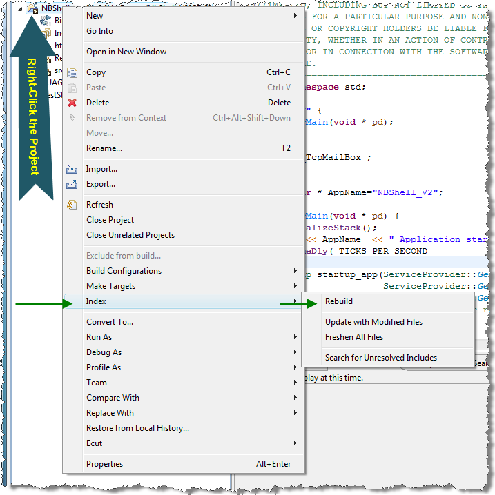

Re: Macro Expansion tooltip of TICKS_PER_SECOND is wrong
In my release (rel24_rc1_beta01 ) the #define for TICKS_PER_SECOND is in constants.h, when I change it the tool tips don't update until I rebuild the index (see the attached image)
