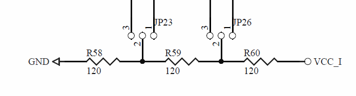

Thanks Tim. The goal is bus impedance matching. A RS-485 bus is a multi-drop bus, meaning it can have more than one device on it. Whether just two devices or many more, only each end of the bus should have 120 ohm termination, and optionally bias resistors. The impedance matching reduces reflections, noise, etc.. The correct settings depend on the specifics of the bus and devices. If you find that with your cabling at 6' or less you don't need termination that is fine. If one device does have termination, you typically want it enabled on the other end as well.
To answer the question, yes, if you install JP23 and JP26 it does add the 120ohm termination and bias resistors. The different pins are used depending on if your using half or full duplex. JP23 and JP26 are each 3-pin headers.
If half duplex, install two jumpers, each in pin positions 1-2 of JP23 and JP26.
If full duplex, install two jumpers, each in pin positions 2-3 of JP23 and JP26.
You will never use just one jumper, otherwise the bus would be biased on one direction only.
That is what the manual is attempting to communicate on page 14.
Here is that section of the schematic:

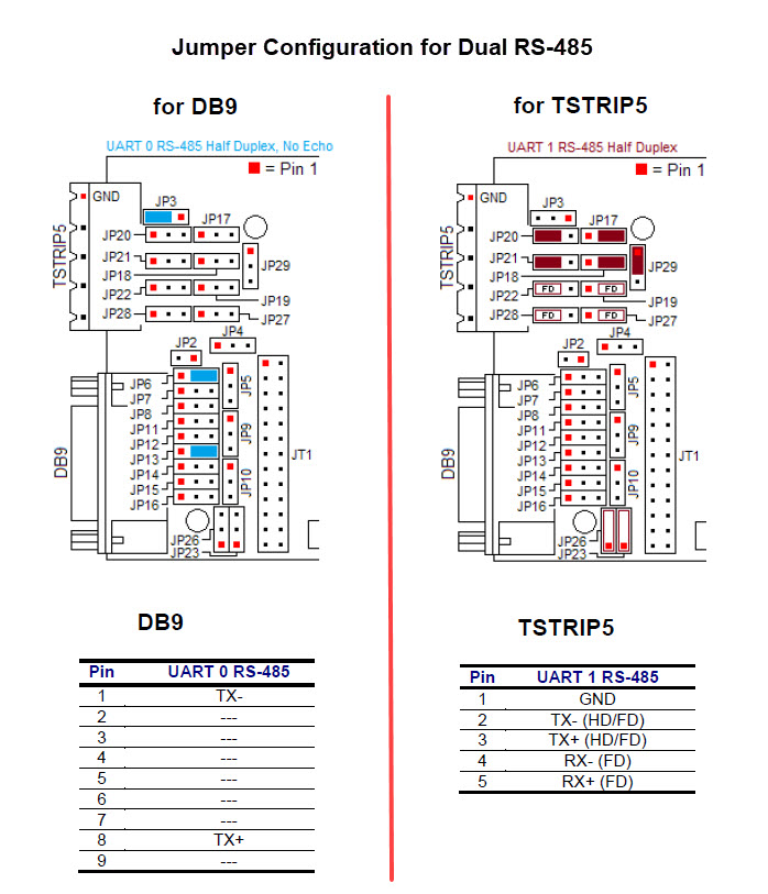

Tom, another question,
If I'm doing RS-485 on both ports, the JP23/JP26 termination resistors only apply to the TSTRIP5 correct?
Are there no termination jumpers for RS-485 on the DB9?
NetBurner Jumper Configuration for Dual RS-485.jpg (143.05 KiB) Viewed 161322 times
Tim
Re: CB34EX JP23 / JP26 Description
Posted: Mon Dec 18, 2023 9:46 am
Hello Tim,
That is correct. If you want termination on the DB9, they need to be added to the connector or cable.
