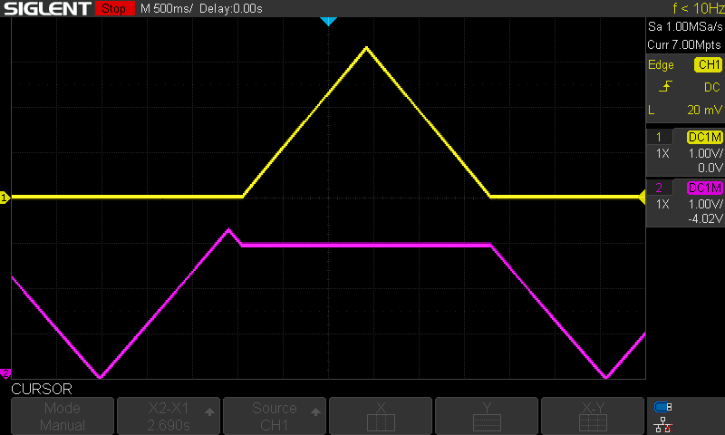

The old style source code compiles and runs, ucos.h has a wrapper that converts the old calls into object member calls. I've modernized it anyways, same problems. An outline of the code is below. While the secondary thread is in its critical section I will see the main thread preempt and enter its critical section when the timer expires and main unblocks. Both threads in the critical section at the same time, the secondary thread blocked. Each thread is outputting triangle to a separate DAC and I can see the preemption on my oscilloscope. In the screen capture below yellow is the main thread, magenta the secondary.

Ignore the oscilloscope screen capture, its actually something with debugging code in it. Its probably a bad idea to spend your time debugging the debugging code. :-)
