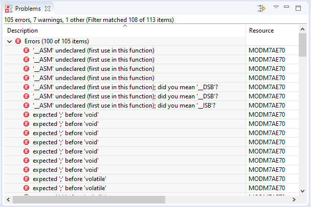

Now my problems continue. I wanted to use the Get_msec() function into my .c file shared between Netburner and STM32. It is conditionally compiled on the Netburner platform only, together with a conditionally added #include <utils.h>
The problem is that when I add these, suddenly hundreds of errors appear:
I think this may have something to do with the
#ifdef __cplusplus
#endif
added in the corresponding .h file.
Any idea how to solve this?

When I add the "extern "C"" but then have to #include a header from Nbrtos something does not work out well and all the errors are thrown. Maybe it is a configuration error, maybe it is because these headers expect C++, not C.
Actually I am not mixing C and C++, I just want a .c file to be compiled as if it were a .cpp by the the NB Eclipse. The problem is that NB invokes GCC instead of G++ when it sees a .c file. I don't want that to happen, I want the C++ compiler to process it as if it were a .cpp file.
Meanwhile I found out that there is a "-x c++" switch that can be passed to the compiler to do what I want.
But I am not sure if it is still supported by the latest gcc version and where exactly I should add it into the Eclipse NB config.
I am sure your expert who configures the toolchain has an idea how to do it properly. Thanks in advance.
Anguel
