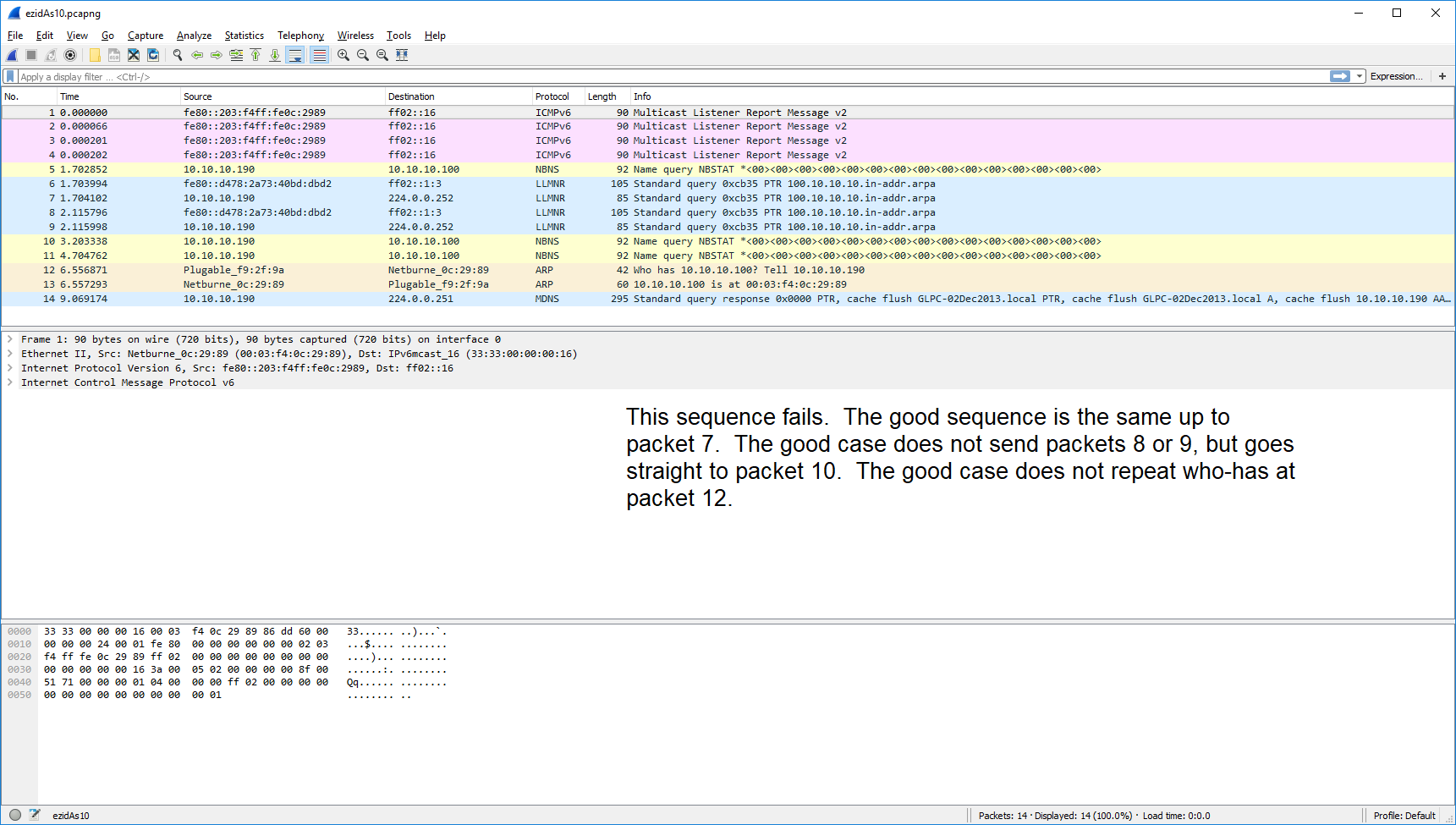

Here is Wireshark showing the failure at 10.10.10.xxx
And the success at 192.192.192.xxx

Followup: it turns out that my customer's code, written for Winsock, is the source of the problem.
			hostInfo = gethostbyaddr((char *)&addr,4,AF_INET); // NULL at 168!
			if ( hostInfo==NULL)
				return(42);
hostinfo is always NULL - UNLESS the whole system is set up for 192.192.192.xxx! Then it works.
So it's not a Netburner question anymore, but I still wonder if anyone has seen anything like this.
