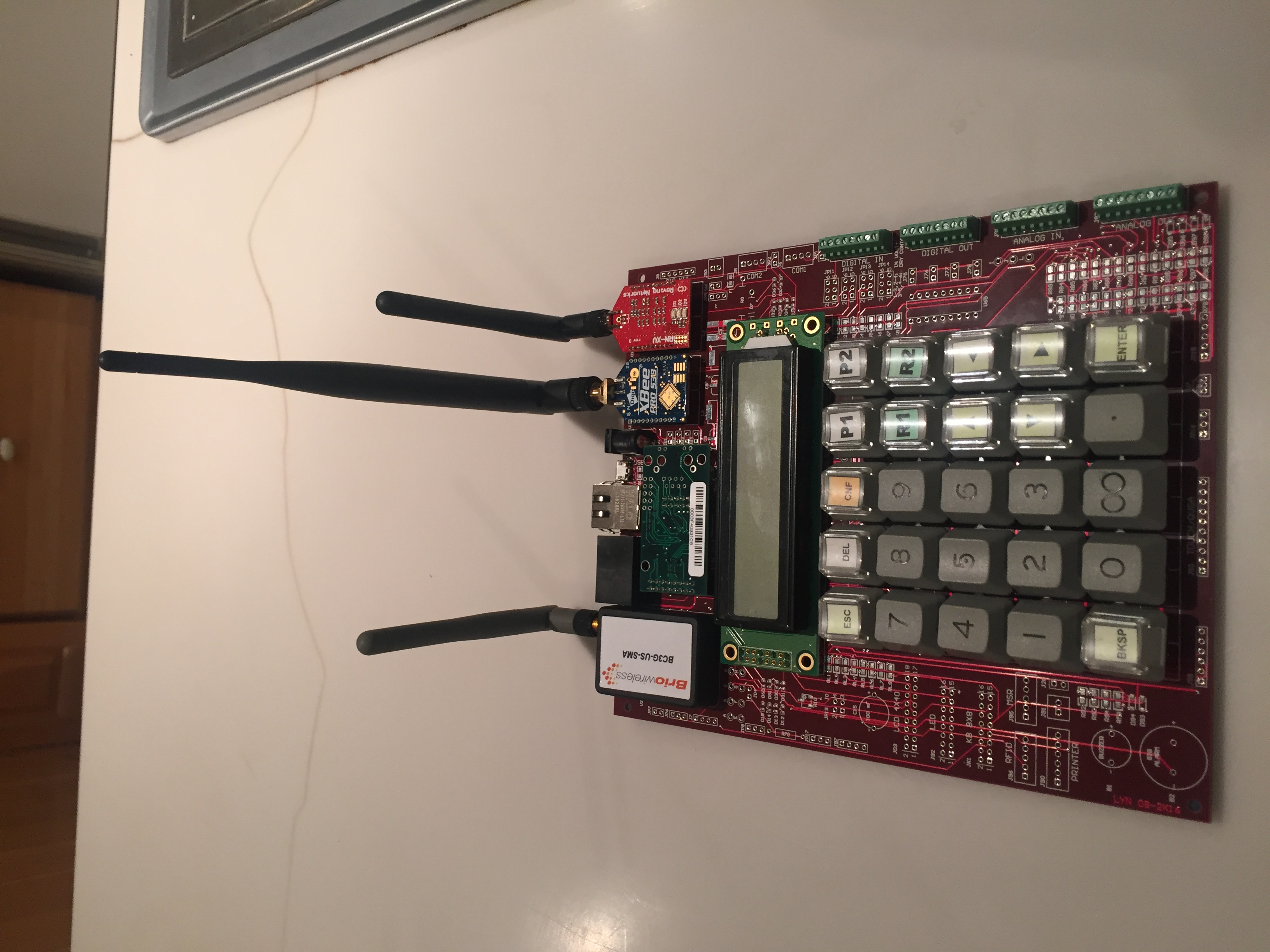

Re: SBL2E-200 in RS-485 Half-Duplex
I Tom,
Sorry for the copy & paste confusion and I don’t have access to my previous hardware design (see the IVD documentation).
1- I tried the “full” free RTS pin3.
1.1 no move in the RS-485 mode
1.2 When program in RS-232 mode with hardware flow control the pin goes to low level. And go back steady high in RS-485
2- In RS-232 mode I’m able to change the pin3 from RTS to a GPIO function.
2.1 Automatically when I program the serial mode to RS-485 the pin 3 goes back to RTS.
2.2 Previously I merely remember that I had to program that pin3 for the RS-485 and today version it is happening automatically!
3- The picture is my new design. The SBL2E is an important component.
3.1 I just want to make it work like a regular RS-485 to Ethernet converter!!!
Tank you for your time
Lyn
Lyn
- Actual project.
- CHRONO_GATE_01.JPG (1.65 MiB) Viewed 30434 times

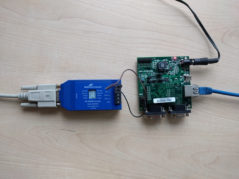

Hello Lyn,
I have tested the device in RS-485 half duplex mode and it is working properly. I took a video of the operation and it is at the link below. The setup is as shown in the picture below. The video shows the configuration, data sent from the network to serial RS-485, and serial data from RS-485 to the network.
In the picture you can see the RS-485 signals from the J5 header of the eval board connected to the RS-485 inputs of an off the shelf 485 to 232 converter. The RS-232 is then connected to the computer comm port 4 running the MTTTY serial terminal program.
This test is running firmware 1.65. We also ran it with 1.68 and the results were identical.
The video link is: https://youtu.be/gXVF_1_-7fk
- Image00001.jpg (150.99 KiB) Viewed 30428 times
