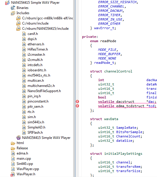

I have searched the forums for anyone else having issues with the NANO54415 Simple WAV Player demo solution and have not found anything. I have been using the MOD5282 for many years now, but have just recently purchased the NANO. I have imported the NANO54415 Simple WAV Player solution files into a newly created project, cleaned the solution, and tried to rebuild with no luck. I keep getting lots of errors, and I assume that I am missing something specific to the NANO development. I am also getting similar issues with the NANO54415 WAV Player demo solution. Here are all of the errors, any guidance would be greatly appreciated.

Re: NANO54415 Simple WAV Player Issues
I think this might be your real problem
"#error PROCESSOR_NOT_DEFINED NANO54415 Simple WAV Player line 50, external location: C:\nburn\include\sim.h C/C++ Problem"
do you have the correct target platform? I think it should be looking for sim.h in the NANO54415/include folder
edit: also, what version of the nndk are you using
Thanks for posting the full compilation error! Yup, as sulliwk said, your issue is the directly related to the PROCESSOR_NOT_DEFINED. You don't have the right PLATFORM set for this to build. You need to make sure that your platform is set to NANO54415, clean, and rebuild. My guess is that you created the project for a MOD5282 instead (or maybe left it blank).

Thanks for the quick responses!
When I started the project I did indeed select the NANO54415 as the platform and Eclipse did create a blank project space with what looks to me as the proper headers (please see attached picture). I also checked that the sim.h was included and from the proper location.
A couple of additional data points:
-I'm running Eclipse 2.6.3
-Eclipse was installed with both the MOD 5282 and NANO54415 licenses.
I have not yet attempted to manually build the solution, but will later today.
Thanks - Mark
Thanks - Mark
- NANO WAV Player Issue.png (41.6 KiB) Viewed 15177 times
Another interesting observation - I now just noticed that not only did the project bring in the includes from c:/nburn/NANO54415/include, but also from c:/nburn/include. Both include directories have sim.h - could this be the issue?
Could this be an underlying issue with NBEclipse installation using multiple platforms?
Guess what - my last post was indeed the issue, it was as simple as pointing to the correct sim.h.
#include <..\NANO54415\include\sim.h>
This looks to be an issue with using Eclipse development on multiple platforms, as in my case with the MOD5282 and the NANO54415.
