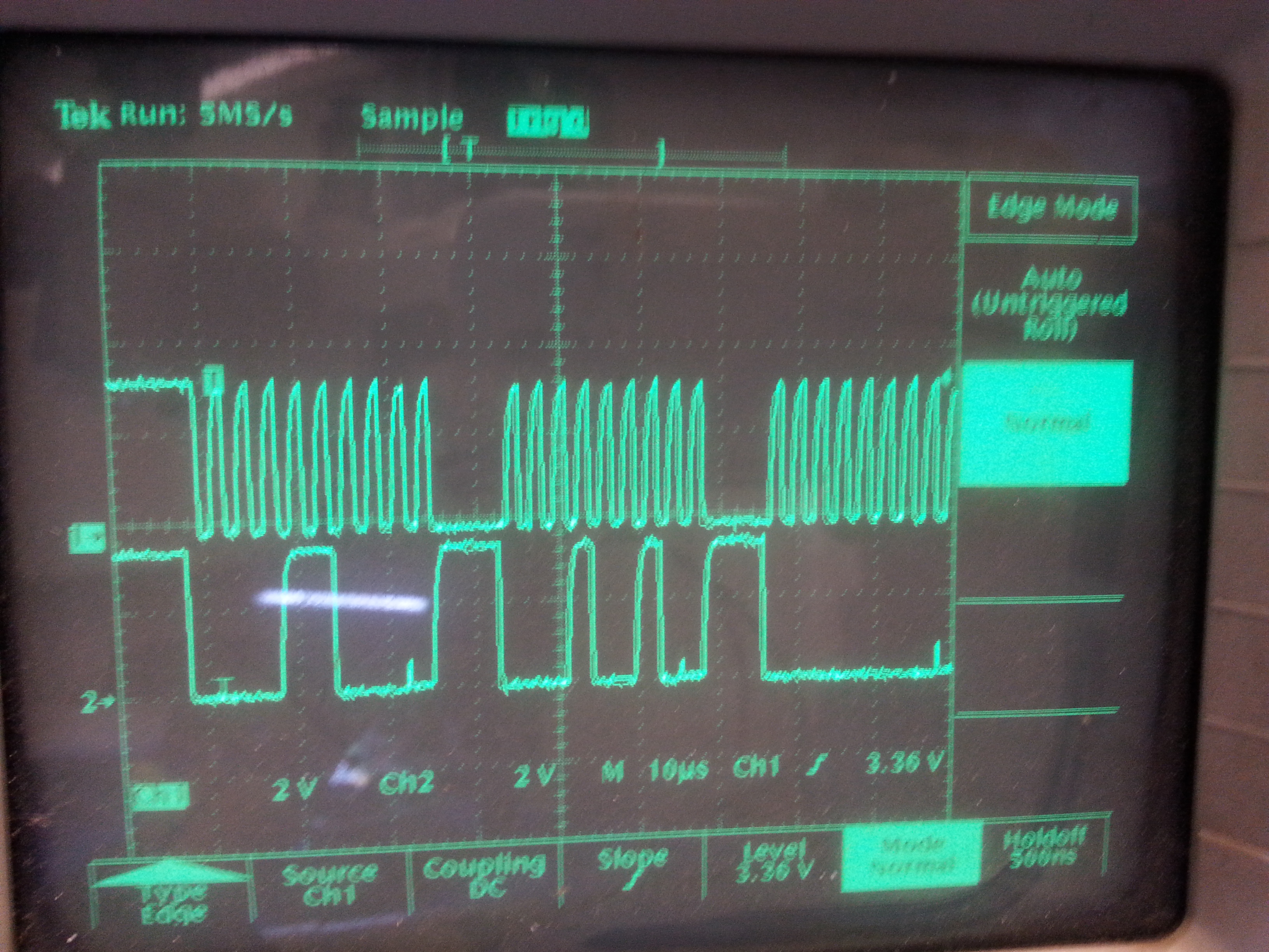

Ok, another update. So I'm getting signals now, but something looks wrong. The SCL line pauses after 9 pulses, for a duration of 3 pulses. Can this be changed in the software somehow? If you look on page 21 of the datasheet for my DAC ( http://www.analog.com/static/imported-f ... D5694R.pdf ) It shows the SCL pulse as continuous with no breaks. I've attached a picture of my scope output (sorry, old scope) showing the signal I'm reading. I'm not getting any output from the DAC at all, so I'm going to have to assume that it's wrong... Anyone know which way to go with this?

And sorry, that picture was much bigger than I thought it would be...
